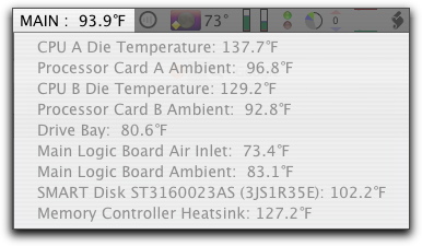

Mine's very quiet, even while folding and doing other work. I think there's an issue - maybe a faulty temperature monitor?
You might want to download Temperature Monitor to see if there are really high readings. Attached below is an example of where my dual-2.0 is now (been folding for days, been doing other work, room is OK but not all that cool).

Edit: BTW, the 73º you see is my local weather (WeatherPop, not the CPU.

I'd at least check the temp readings to make sure they make sense.
Guys this has been discussed a lot of times here! It is probably a sensor that is too close to a heat generating device, therefore giving false information to the processor, that lets the fan spin harder = louder! If it is a dual 2.0 rev A, it is probably the sensor near the harddisk. That was common, heard it a lot around here. Try and move the sensor a bit away from the harddisk and this will probably solve your problem!
