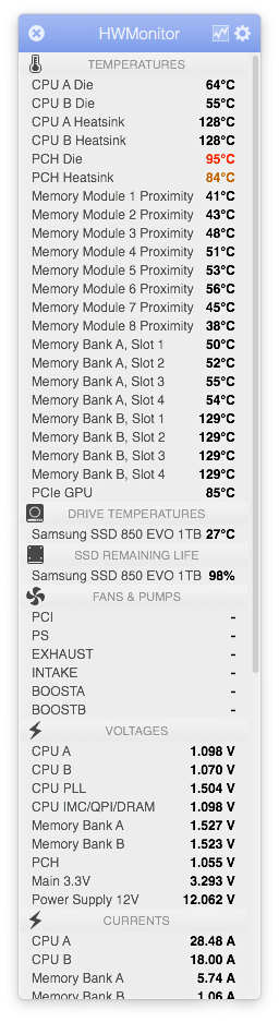

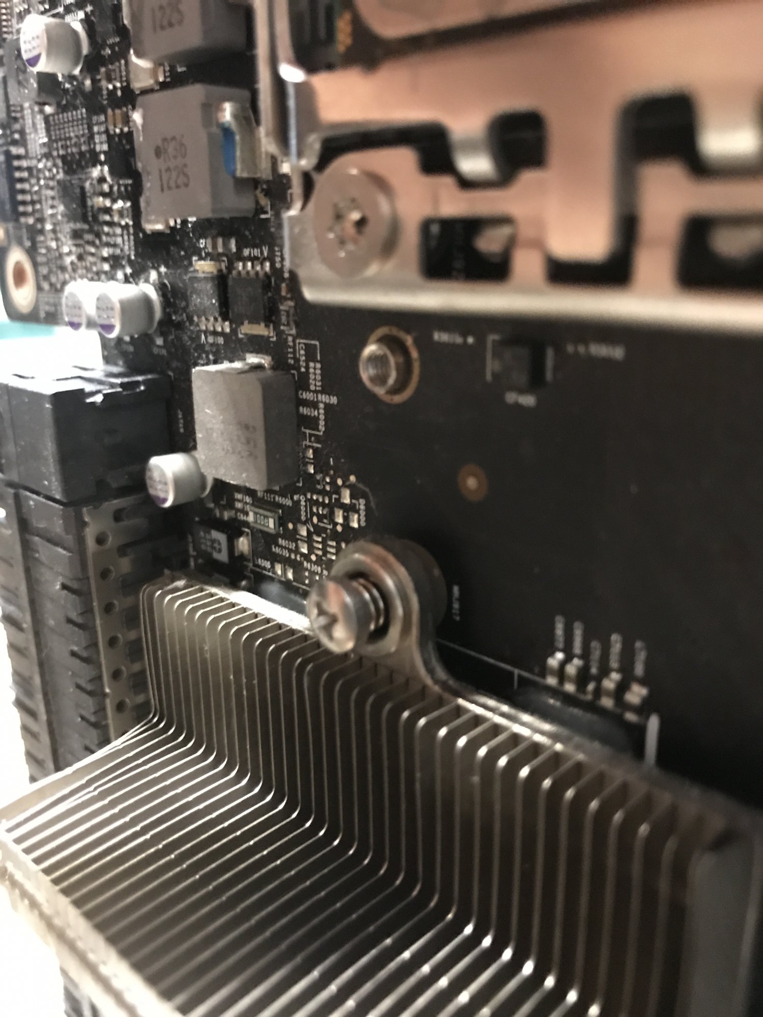

- Maybe the Heatsink is bent due to the high temperatures and just can't seat entirely any more on the Northbridge, so it can't receive the heat and do the cooling job? Don't know if I've tightened it too much or not enough. I tried 3 different pressures, but no impact on the temperature. The last, most tight is on the picture.
- I have another cMP5.1 here, so I could maybe use some parts from there for the diagnostic purpose. Should I try to replace the Northbridge with the one from another machine?

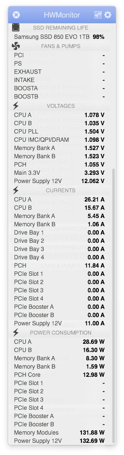

- Do you see anything strange on the HWMonitor statistics?
- What do you think about the 20W and RAM?
- What would you do first?
