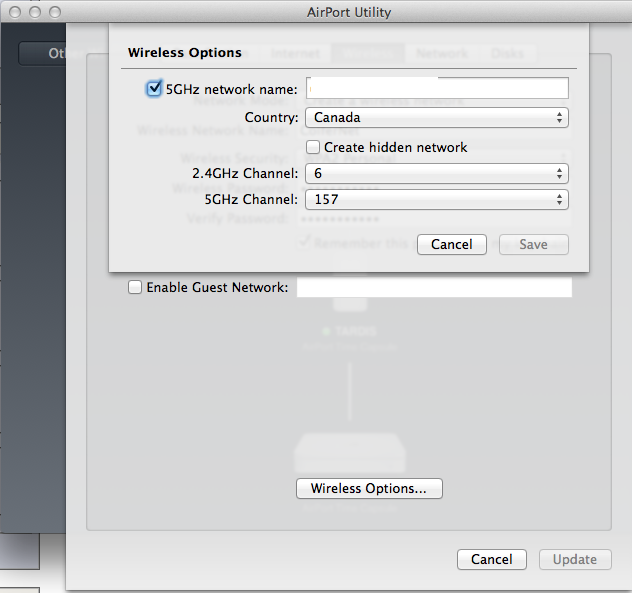

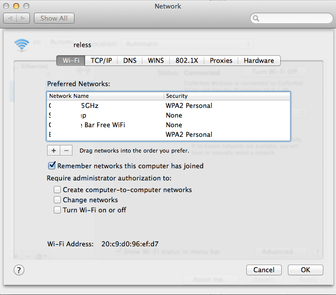

Are you connecting at 2.4 GHz or 5.0? You only get AC speeds at 5.0
To try to make sure you always connect at AC do the following:
1. In AirPort Utility set a separate name for your 5.0 GHz network.
2. In Network Preferences, drag your 5 GHz network to the top of your preferred list.
