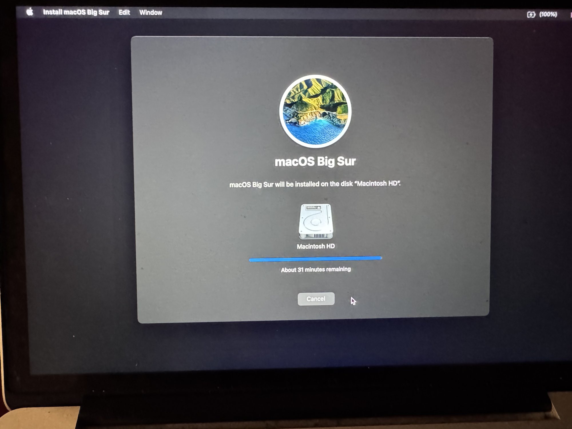

Yes that’s correct it connects in safe mode
Reinstalled after holding down CMD + R which put it in recovery mode and now on this screen

"...Recovery keeps your files and user settings intact when reinstalling."
