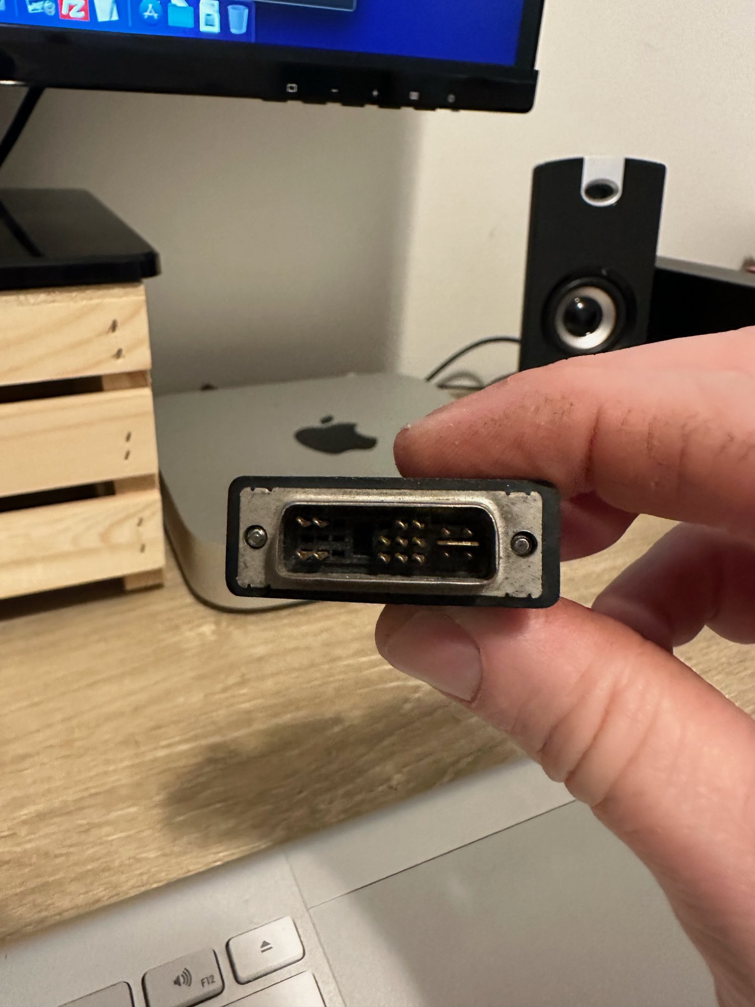

As per subject, I need to find one of these. It can't be a DVI-D to VGA adapter, as those don't work with the Mini G4, and the regular straight adapters are too long for what I want to accomplish. Anyone know where to get one? I tried eBay, Amazon, and Newegg with no luck.
Here's a photo of the pin layout:
DVI-I is required for the analog signal pass thru to VGA.

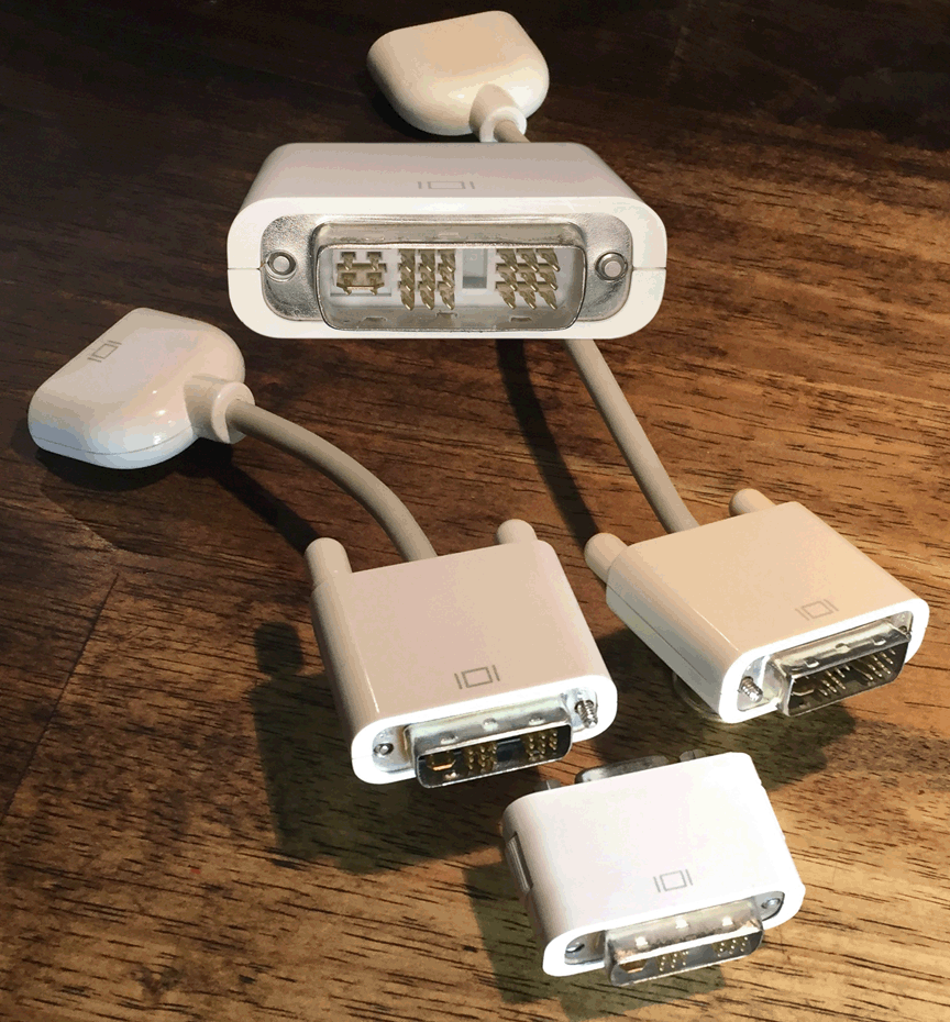

Thanks. I ended buying Apple's DVI single-link to VGA adapter. That'll work and give me the room that I need for it to clear the space that I need. It turns out that the cable I bought for the conversion was a DVI-D cable. Learn something new every day.
"Does Mac mini G4 not support DVI-D?"
I guess it doesn't, or, rather, not the frequency that my modern monitor requires.
