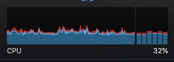

Render is done and closed all programs. Will check next time. It could be that it's leveraging out to the GPU too?

It’s normal - After Effects has to compile the frames linearly and many effects and processes aren’t multi-threaded so it will rarely, if ever, saturate all the cores.
You can’t exactly blame Adobe either, that’s how processors need to be worked in order to efficiently compute what is needed with modern systems. It’s not like you could find another program with the render flexibility of AE that would do the task faster.
They are in the process of rewriting AE to something even more optimised, but it’s a big job and still a little while off.
Just because it isn’t using 100%, doesn’t mean you don’t get improvements from more cores and higher clock speeds etc
