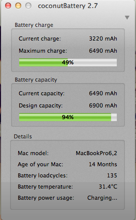

Attached is a screen shot of the current status of my battery.

There are many reasons why your battery might not be last as long as it should. However, your battery indicating 6490 mAh is very good. I would've suggested replacing the battery, but the software might be bogging it down for some reason.

Your battery is perfectly healthy, the problems likely lies in software.

Download coconut battery and check on the capacity %. If it still has a good capacity, it's not the battery that is the problem but something that is taxing the CPU and using a lot of power. If this is the case, check activity monitor for runaway processes.

I already did that and posted the screenshot above of my coconut battery findings.
