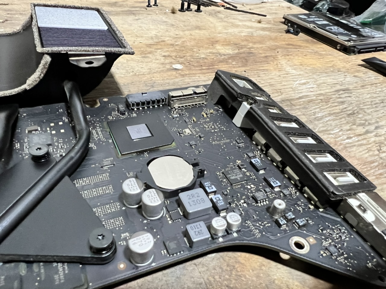

Hi guys,
I know this has been discussed but I’m looking at a interesting option that I can’t seem to find an answer on.
This Late 2012 21.5 IMac mother board has a spot for a Blade style SSD. From my research, it needs a Gen2 apple proprietary SSD and the screw to hold it down. I know there is a 768GB SSD I can buy.
Has anyone done this? I bought a 512SATA SSD to replace the HDD. But then I saw this unused blade SSD port. Im thinking sending the Sata SSD back and getting the other SSD or keeping it and using it as a extra HD internally.
I’m also installing the I7 3770 and 16GB ram. I was given this computer for free, so I took chance to upgrade it. I also should upgrade that watch battery lol.
Any thoughts, opinions?
No reason to use the blade SSD over the 2.5", unless you wanted an internal SW RAID set up.
The Apple blade SSDs are SATA, and limited to 768GB, and have no speed advantages over the 2.5 SATA.
I am unsure if you can even find the Apple blade SSDs new anywhere, and used on eBay would probably be the best place.
You can get adapters to put a larger NVMe into the blade SSD port, but still, there would be no speed advantage. One advantage of the NVMe over the Apple SSD is probably price. I haven't checked in a while, but the Apple SSDs, even used, are very expensive.
Personally, I would just stick with the 2.5" unless you already had a blade SSD around somewhere, or if you were interested in an internal RAID set up.

Ok, that’s what I was wondering. I did find them for 123.00 for 768GB version. I’m not that computer savvy, I don’t know how to do raid setups.
I just thought it might be faster. So can this system take 32 gigs of ram? I bought the 16 but maybe off the books they can use 32?
I was just going to use this computer as a spare and then probably just sell it upgraded.
Do I have to do all the trim support stuff while I do an internal SSD upgrade?
I know I should’ve asked this question before I bought the 16 lol. You know how it is lol.
This is, unfortunately, not one of the Macs that has a discovered upgrade for the RAM. 16GB is max.
The 21" Late 2012 iMac has only two RAM slots, each taking up to 8GB stick. The 27" had four RAM slots, allowing 32GB of RAM.
But, 16GB is plenty for most people. Besides, just going from the HDD to a SSD is a night a day difference in performance and experience.
I am not exaggerating when I say that swapping the 8 year old HDD for a new SSD will make it feel like a totally different machine.
If RAM ends up being an issue and 16GB just isn't enough for your workflow, having the much faster SSD will help out a lot.

Very good advice. I will add some:
Clean while everything is out, blow out the fan with an air compressor or a can of compressed gas electronic cleaner.
Clean the old adhesive with alcohol, and make sure you get it all. A bunch of posts here of people doing the mod that you are doing, then have their screen fall out of their iMacs, breaking as it hit their desk weeks after putting the screen back on.
Give the adhesive strips time to take hold. I recommend holding the glass onto the iMac body with some painter's tape for a few days. It won't hurt anything, easy clean up, and might save your Mac in the long run.
The painter's tape might be a good thing to try, even before adding the adhesive strips, just to make sure everything works okay before glueing it back together.
Use the SATA temp sensor adapter to keep the fans in check after the SSD swap. Otherwise, the fans will run at full speed and stay there when you turn on your Mac. There are free alternatives like SW solutions (Macsfancontrol for example) and HW solutions (shorting the temp sensor wires, adding your own temp sensor, etc.). Personally, I just like to use the adapter, but I understand the $35 adapter might be out of people's budget, especially after buying new SSD, RAM, etc. Comment is not applicable for the 21" for this year. See below.
You probably won't want to do this one since you have everything taken apart, but I would have upgraded the OS to at least High Sierra on the HDD prior to doing the SSD swap. This would install firmware that might not otherwise install once you do the swap.
Also another thing I would have done prior to the swap, I would have made sure the SSD worked using a USB/SATA adapter or enclosure. Install the OS on the SSD, and migrate any files and apps from the HDD that I wanted to keep. Booted from the SSD, make sure everything is working fine. Only then, do the swap.

You have been wonderful. I appreciate it! I will get that battery. Also, I put Catalina on my external SSD I was booting from. I would go further, but the. I have to do hacks? I’m not really into that.
I have Carbon Copy Cloner. When I reconnect the Samsung drive, I will clone it to the new internal SSD.
But, what you said about testing before hand is a good idea! I never thought of that.
This is a second machine. I have a new 16 M1 pro as well. I was fortunate enough to receive this iMac for free.
I’ll look into the temp sensor as well.
I’m going to make sure it all works before I tape the screen back on.
