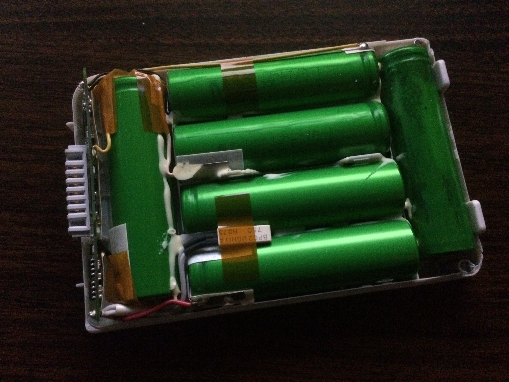

I actually did exactly this a few days ago. They are an absolute nightmare to open but I was able to replace the cells successfully.
Here is what I suggest. Like @micahgartman says, use an Xacto knife (or similar) to make deep cuts along the seam where the top and bottom halves of the case join. By doing this, you will cut through the thin layer of plastic behind it which contains the small clips holding the halves together.
Of course, you will no longer be able to snap them back together again but at least you won't end up snapping the case trying to pry it apart. In mine, only one cell was actually bad, so once I soldered in a replacement, I simply put a bit of epoxy to glue the two halves back together. Job done and works great!

There are 6 cells inside arranged in 3 pairs of 2. One pair is connected by wire so is easily soldered. The other 4 cells are spot welded together. The cells in mine are Sony US18650GR (G7).
The cell on the far right was the bad one of course.
