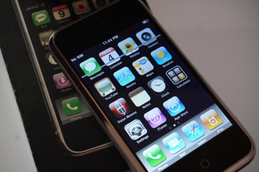

I have an original AT&T 1G iPhone (complete with all accessories & original box with matching S/nos) stored in a safe, dry environment and occasionaly take it out to partially charge the battery - which still maintains an excellent charge.

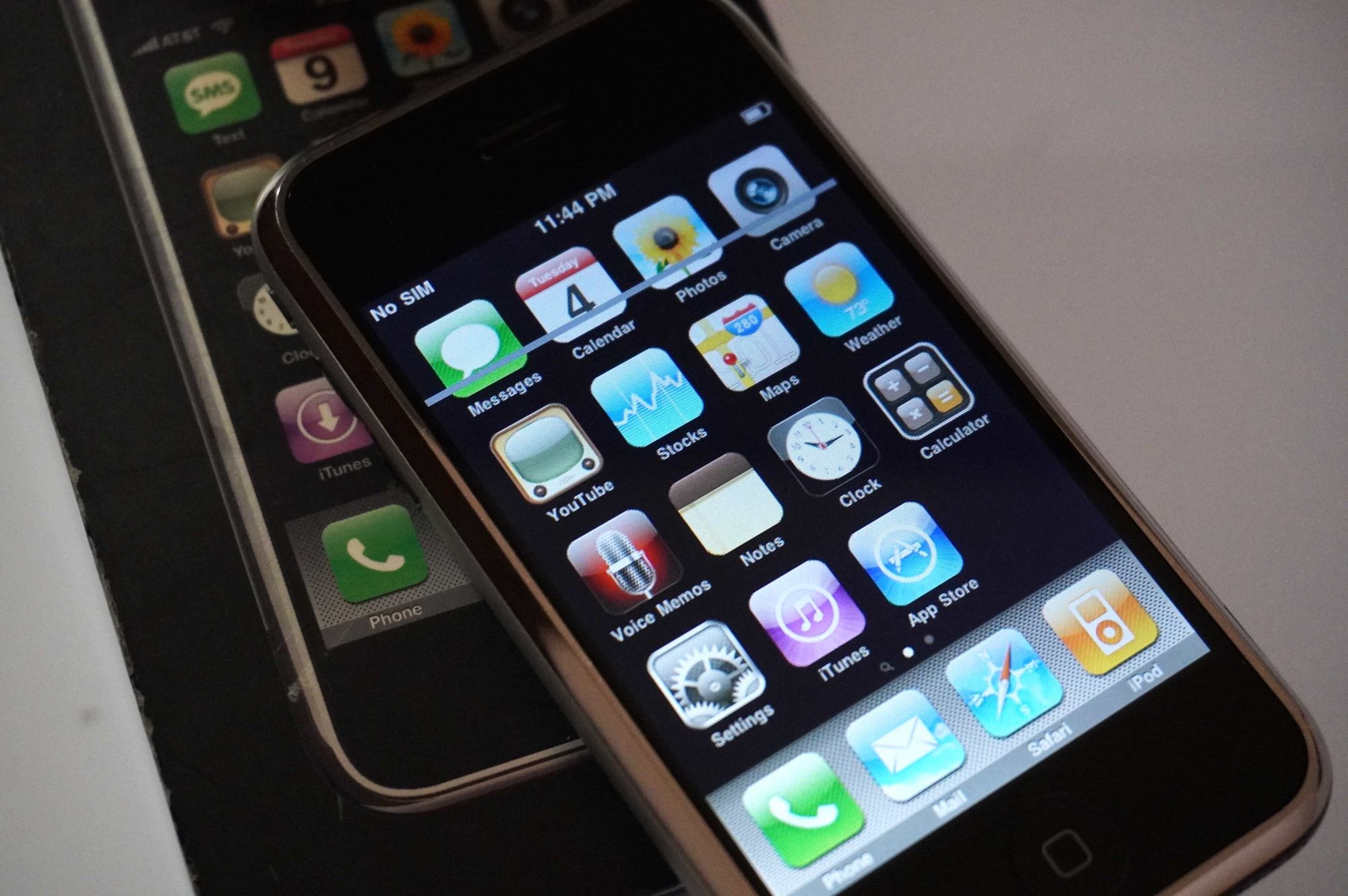

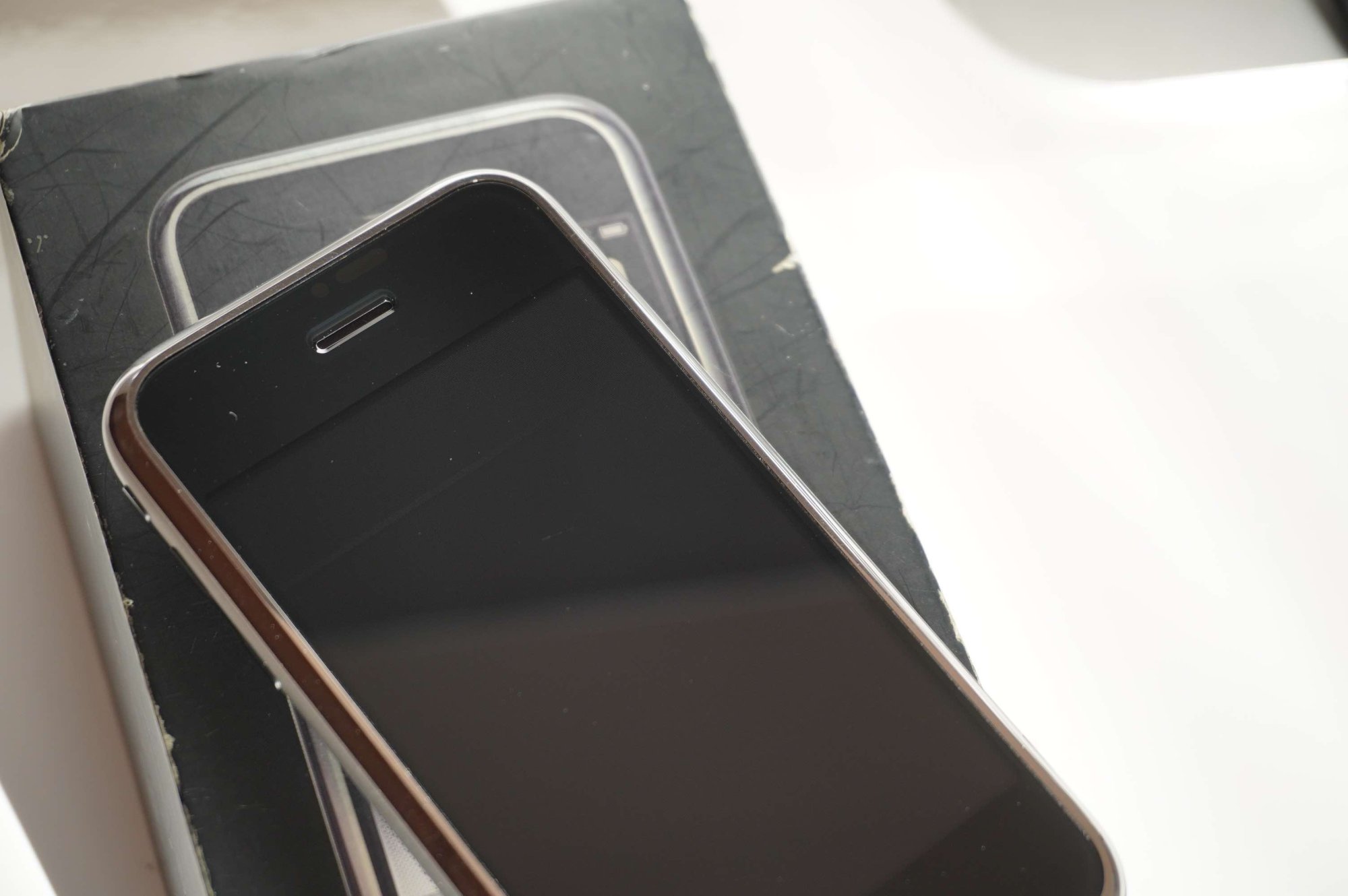

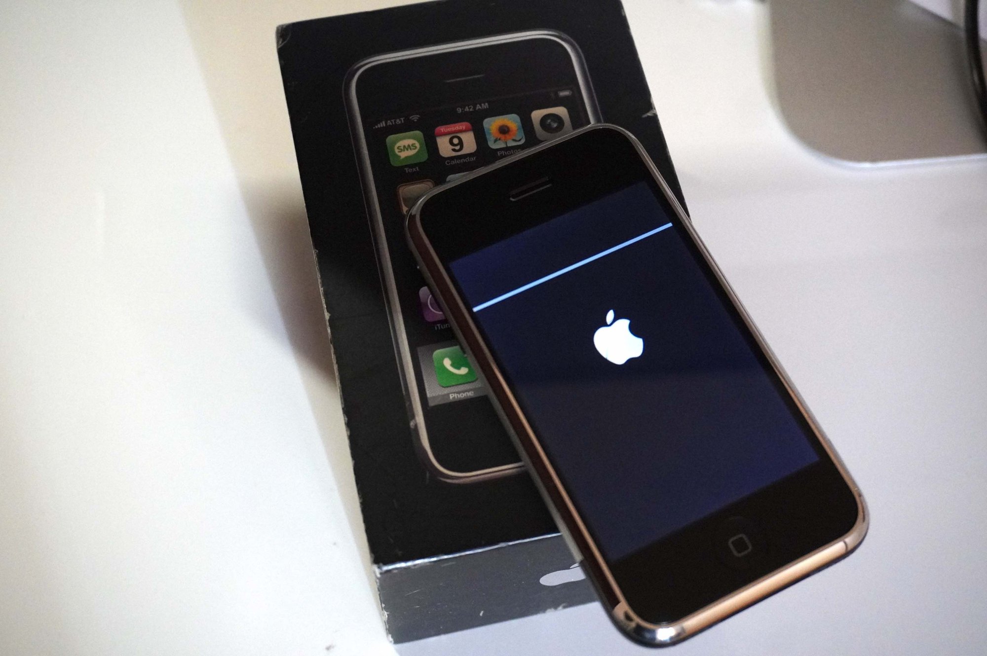

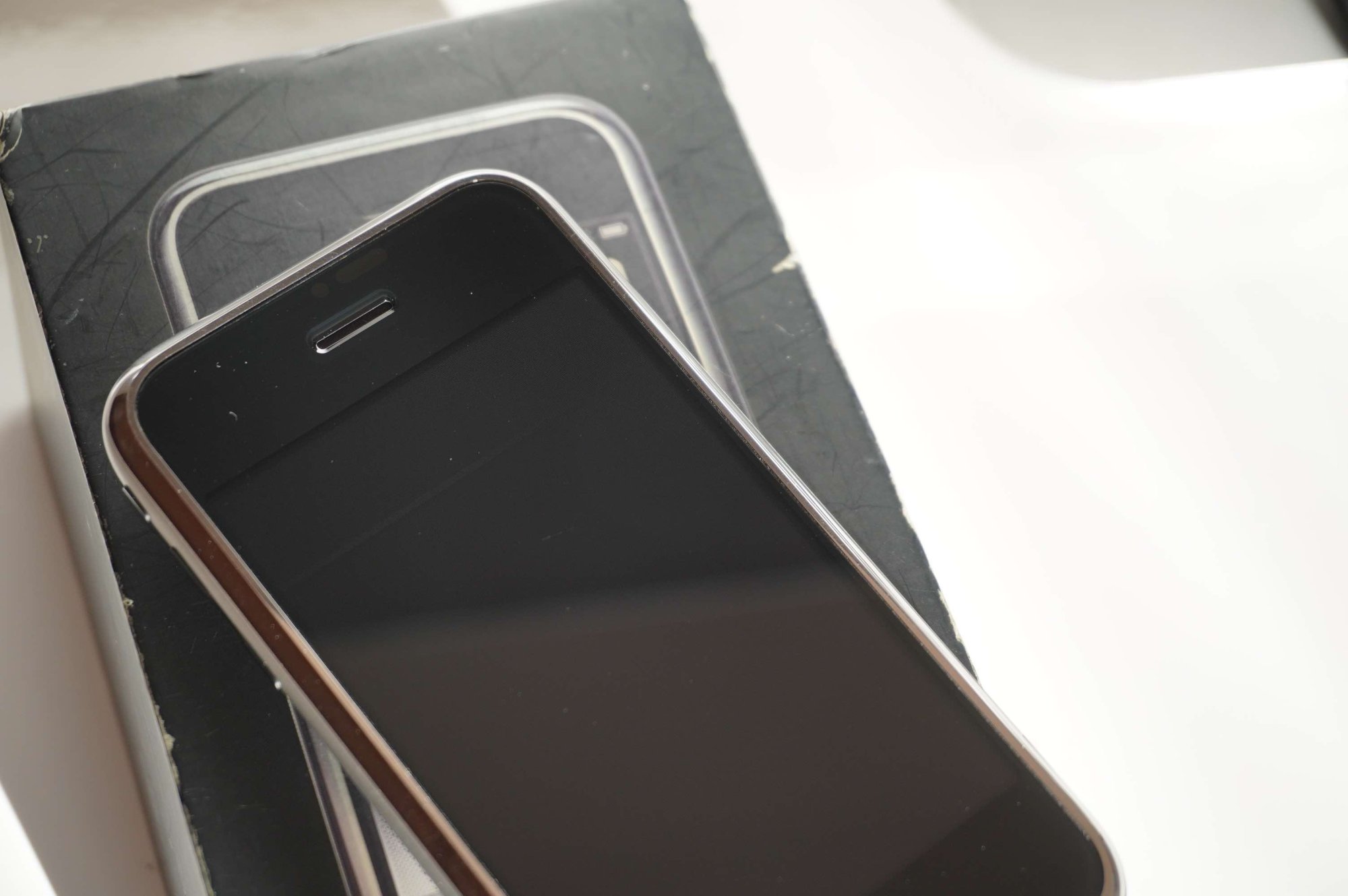

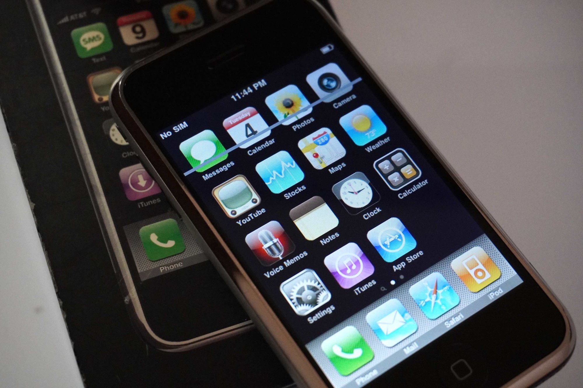

Yesterday however when doing the same I had a fright in noticing that there is a horizontal line/loss of pixels near the top of the screen. The image on the rest of the screen is still as good as on day one. See attached photos - the line is still slightly visible with the phone switched off (ref photo #1). Those are a few specks of dust at the top - no other obvious loss of pixels.
Can anyone guess what may have caused this? And especially how to remedy it!
In the past I've taken apart several troublesome 3G and 4g iPhones just for the fun of it, and returned them to good working order, and although I never anticipated opening up my original 1G phone, I'd be prepared to do it in order to reurn it to it's almost mint condition.
Would appreciate any helpful comments.......
Possible battery beginning to swell putting pressure on the back of the display? I know you said it holds excellent charge and you've been maintaining it but it's still 16 years old.. Just a guess..
Thanks for the comment. A similar thought had passed my mind having experienced a swelling battery in a Macbook which started to interfere with the control of the trackpad.
If it should transpire to be caused by the battery, does that announce a terminal malady for the screen?
I'd say you have a fair chance that once the pressure is removed, the screen may return to normal

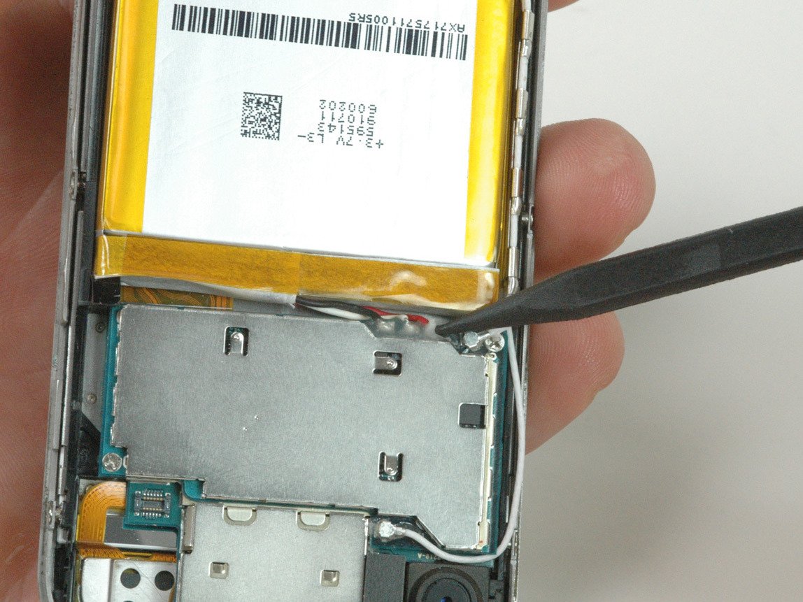

Just goes to show that no matter how careful you are with your phone, the display will just kill itself one way or another eventually. It's likely a damaged display, I would leave it as is, it would no longer be in this mint condition it's opened up and parts are swapped out. Then it would just be like any other iPhone. Although if the battery is swelling then it is a fire risk and should be fixed sooner rather than later. Though you'll find out soon enough, a swelling battery can force the phone to come apart eventually. You can open it up following an ifixit repair guide.
Seems very simple to open it up - but similarly to the iPod Classic, it has the typical issue that during opening you will bend the housing a bit when you use a tool to pry it open. That's just awful design, but it's how Apple did things back then. If it happens you can either try bending the housing back afterwards, or get a brand new housing off Ebay. I don't know if these are still sold at all, and they might not be an original part. At the very least they wouldn't show the correct serial number if there is one on it.
Discharge the phone fully until it no longer turns on, before you open it up. If you end up removing the battery it is best if it's completely depleted, once it is out it is harder to deplete it.

Someone correct me if I’m wrong. But weren’t Gen 1 batteries soldered on? That ups the problem a bit.
EDIT: Yup, soldered on. Most shops are not keen on this… But you never know.
