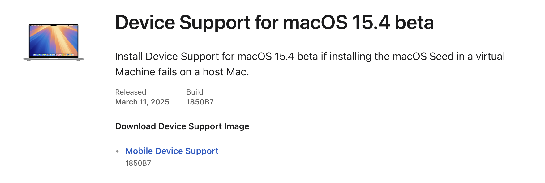

I just started it and got that:
Installation of 15.4 RC seems to work. But I would wait if it's not the first one.

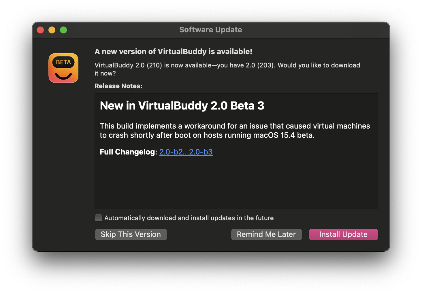

Virtualbuddy tells me I am up to date on version 1.7, do I need to download the latest Virtualbuddy?

I just installed and replaced my original 1.7 Virtualbuddy with 2.0-210 beta. I get the same error.

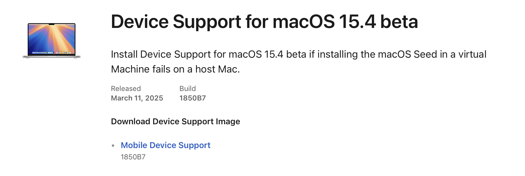

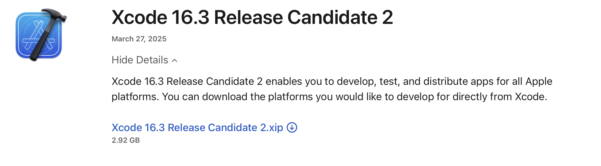

I installed 15.4 RC without any problem in Virtual Buddy. But it was RC1. And I have installed also that tool and Xcode Beta that includes it.

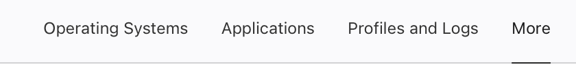

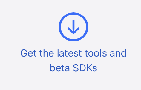

You just need an Apple ID to login, agree to the TOS and you are in the Developer Portal. No new account needed.

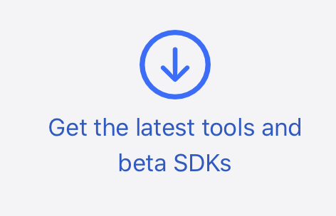

Scroll down to the bottom after skipping the customization and you will find everything there:
This was the trick I was missing. OSx15 is installing, we will see if it was successful in a few minutes but now that its actually installing I have high hopes. Thank you so much for your assistance!
