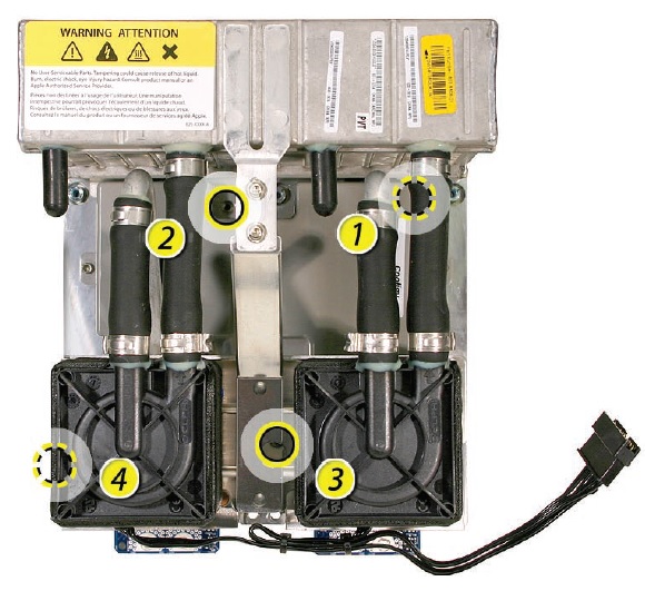

The above guide linked to by @ftalbot is for version 1 of the Quad CPU LCS (pictured below)

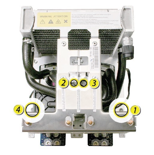

I have version 2 of the Quad CPU LCS (pictured below).
Does anyone know of any troubleshooting guides specific to version 2?

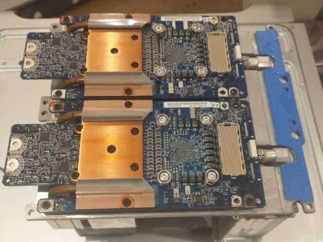

I disassembled the LCS and I don't have any leaks. Is there thermal paste that can be reapplied?

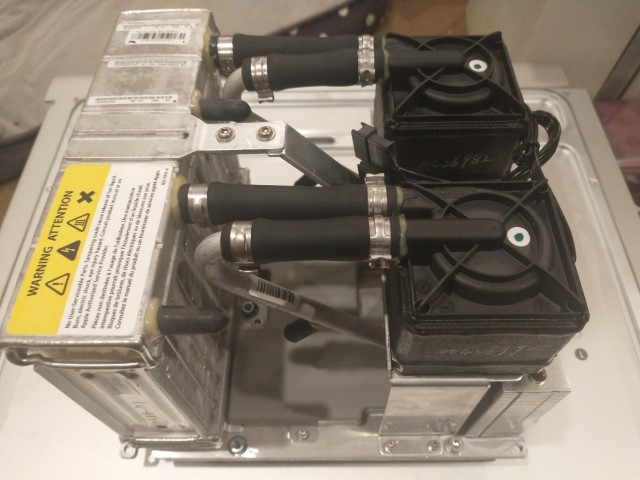

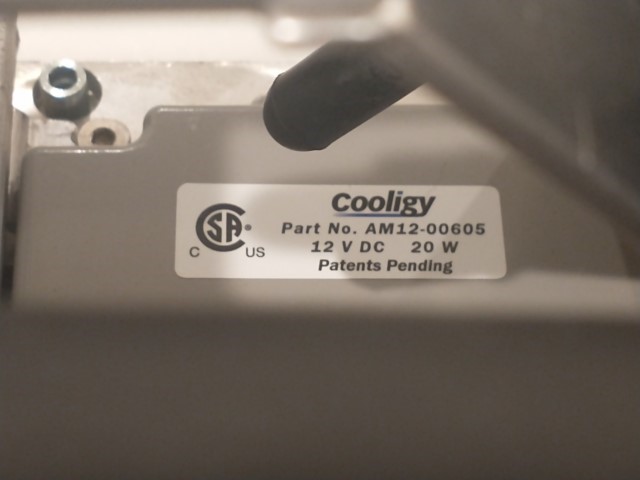

Pics of my v2 LCS below:

Stupidly I had tried this before these instructions were out and ended up having to wreck the inlet shown on picture 4 above, if only I had had those instructions 😂
