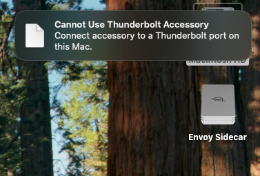

I just finished a clean install on my new Mac mini M4pro 24/512.
Everything went smoothly until I plugged in my OWC Thunderbay 4 enclosure and I received this message: "Cannot Use Thunderbolt accessory Connect to a Thunderbolt port on this Mac"
I tried different direct ports on the Mac, I don't think it's the cable because the Thunderbay works on my Intel Mac (2018), M1 laptop, M2 laptop.
The only difference between the machines is the M4 is running Sequoia while the others are on Sonoma and Ventura.
I see there may be a firmware update on the Thunderbay but it doesn't appear to relate to OS.
Any thoughts?

I'd certainly update the firmware; it may not be an OS issue so much as the chipset on the new mini.
The M4 Mac mini is the first Mac mini that Apple has shipped that doesn't have every USB-C port enabled with Thunderbolt. It's nice they kick that system message when a TB devices is connected to one of the front USB 10Gb/s ports.
I don't doubt there will be plenty of M4 Mac mini users encountering this. Especially since would be used to every Mac mini USB-C port having Thunderbolt capability on all the prior USB-C equipped models.
No firmware update, cable change, etc is required to use any of our OWC Thunderbolt devices on these latest Macs. Plug n' Play and go. Plug into a Thunderbolt enabled USB-C port and you're off to the races.

Front ports on the Mac mini are only for USB 3 10Gb/s. Based on the message that came up on the system, as emoon3 suggests, use of those front ports was being attempted.
Zero issue to expect when connecting Thunderbay or any of our Thunderbolt solutions to a Thunderbolt port on the back of the new M4 mini.

Thank you emoon3 and Larry....you are correct, user error.
I used the back port with a dongle that I thought supported TB, received the error message, and tried the front port and received the same message. When I plugged into my laptops and everything worked, I started down the wrong path of thinking it was an OS issue or something related.

I beg to differ with OWC: I just received my M4 MacMini yesterday and I cannot mount or see an external SanDisk G-Drive Pro, with two T3 ports. And, I've tried all of the ports on the MacMini.
I just posted this to the Apple Community:
Not exactly the same problem, but close: I have a T3 SanDisk G-Drive Pro that I have been using via its USB-C port with an older Mac. I just received my M4 MacMini and was looking forward to a performance boost by using the Thunderbolt 3 ports that are also featured on this external drive. The M4 MacMini does recognize the drive when I use the USB-C port, but does not recognize the drive when I try to use either one of the two T3 ports. The results I get are:
1) A window pops up stating that the external T3 Accessory can't be used, and that I should connect it to a Thunderbolt port on this Mac. (Almost like the MacMini doesn't know it has Thunderbolt 4 ports.)
2) It does not show up in Disk Utilities at all, when connect to the T3 ports on the external hard drive.
A final note: I also purchased an OWC NVME external T4 drive (Envoy Sidecar), that is recognized by the MacMini, but, it shows up in Disk Utilities as a USB device. I don't know if that means anything, but, there it is.
