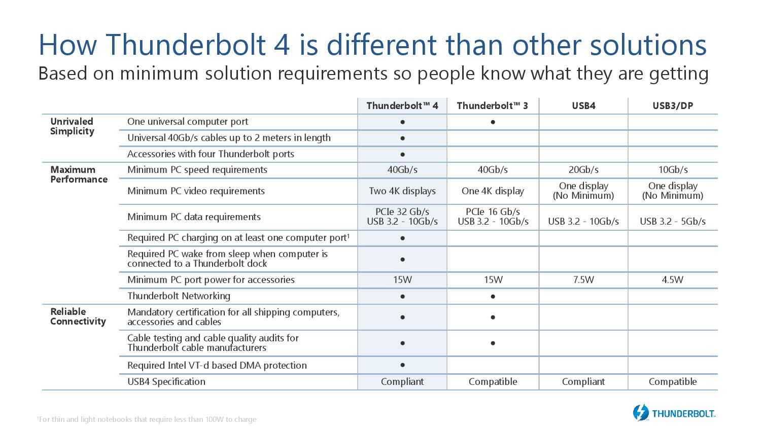

The video talks about how Apple has always done the "right thing" with Thunderbolt on the Mac. Right up until the M1. The M1 systems can't be Thunderbolt v4 certified because they don't pass the 4K video out on every port test. The Mini M1 goes backwards in video out support. That's way Apple uses the phrasing "Thunderbolt 3 /USB4".

What do you mean by "they don't pass the 4K video out on every port test."?

Thunderbolt v4 is a bit skewed toward Intel. Not too surprising. Their gen10 and gen11 U series processors with integrated TB controllers have a four DisplayPort v1.4 stream attached so meet the spec. ( also all get a clean switchedd x4 PCI-e v3 feed also) . But it is also more uniform. If it is a TBv4 system then it doesn't matter which port you choose it will always have a video signal present. ( so you don't have pull out your USB4 symbol decoder ring to find out which feature is on which port on which system. ). TBv4 is largely about not having to worry what part of the optional parts of the USB4 specification the system implementer skipped.
There was a recent posting the seemed to indicate that Apple's integrated TB controller has the baseline ability but just isn't fed the four streams from the internal iGPU. So the M1 comes up short probably based on having a limited iGPU.
Insert a more capable iGPU into the Apple Silicon die and then Apple could get the TBv4 label ( if they bother to go through certification process ) .
That is part of the Thunderbolt v4 certification criterion. Someone tried to link in the table graphic above but more clearly. ( see line 5. Minimum PC video requirements. )
