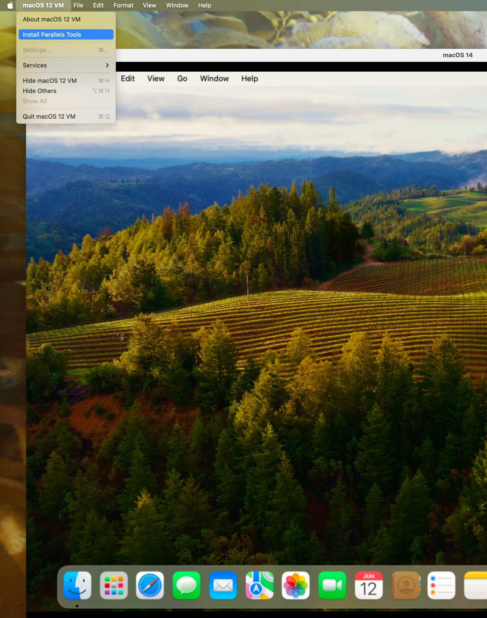

I was going to install Sequoia as a VM in parallels 17. My step was to first create a Mac Sonoma VM and then drop the installer for Sequoia in there and update. Sonoma installed no issue, issue came when I tried to run the Sequoia installer. The Mac OS VM said there was not enough hard drive space. Not a problem I thought, I will just edit the hardware. I shut down the VM and try to edit the hardware settings but have no options to do that. Then I think I need to install the Tool Box, which is where the issue is. When I have the VM running:
1: Select Install Parallels Tool
2) Select "install" from the box that pops up after that.

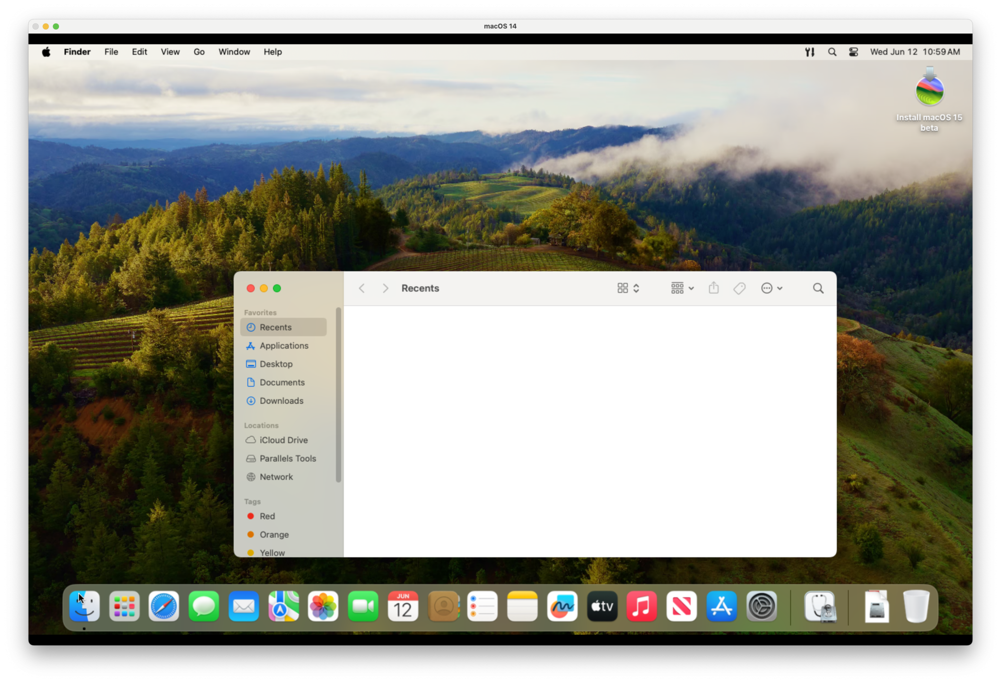

3) One I have selected Install immediately a finder folder opens for the Recent folder
Am I missing something here? Nothing in Privacy and Security to allow the app to install, just the recents folder open.
