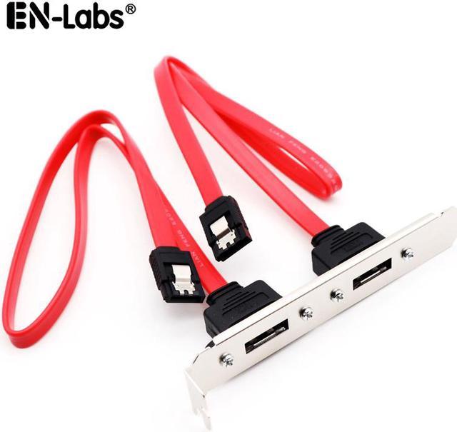

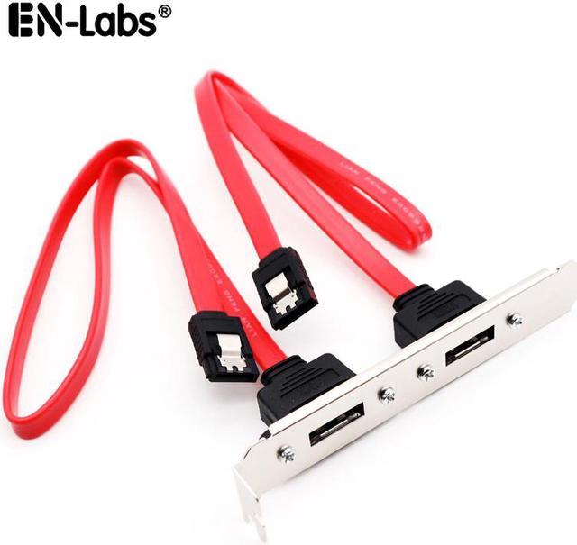

I have a Sonnet Tempo for my G3 B&W that was gifted to me. I realize you're asking about eSATA, but an easy way to get that is to just buy one of those converters. A picture will probably explain it best…
Attach the other ends to your PCI SATA card ports, put the frame in a slot and you have eSATA.

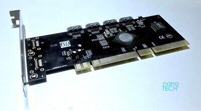

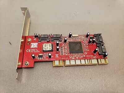

Just a quick search…(MODS NOT MY AUCTIONS, JUST SHOWING EXAMPLES).
I have one of these…
I also saw a number of 3112 based cards in the $20 range.
Thanks @eyoungren! I purchased the second one of the two you suggested. Cards like this did not turn up in my search because I was searching for eSATA, not SATA. Now I will add a SATA to eSATA adapter and be done! Thanks!
