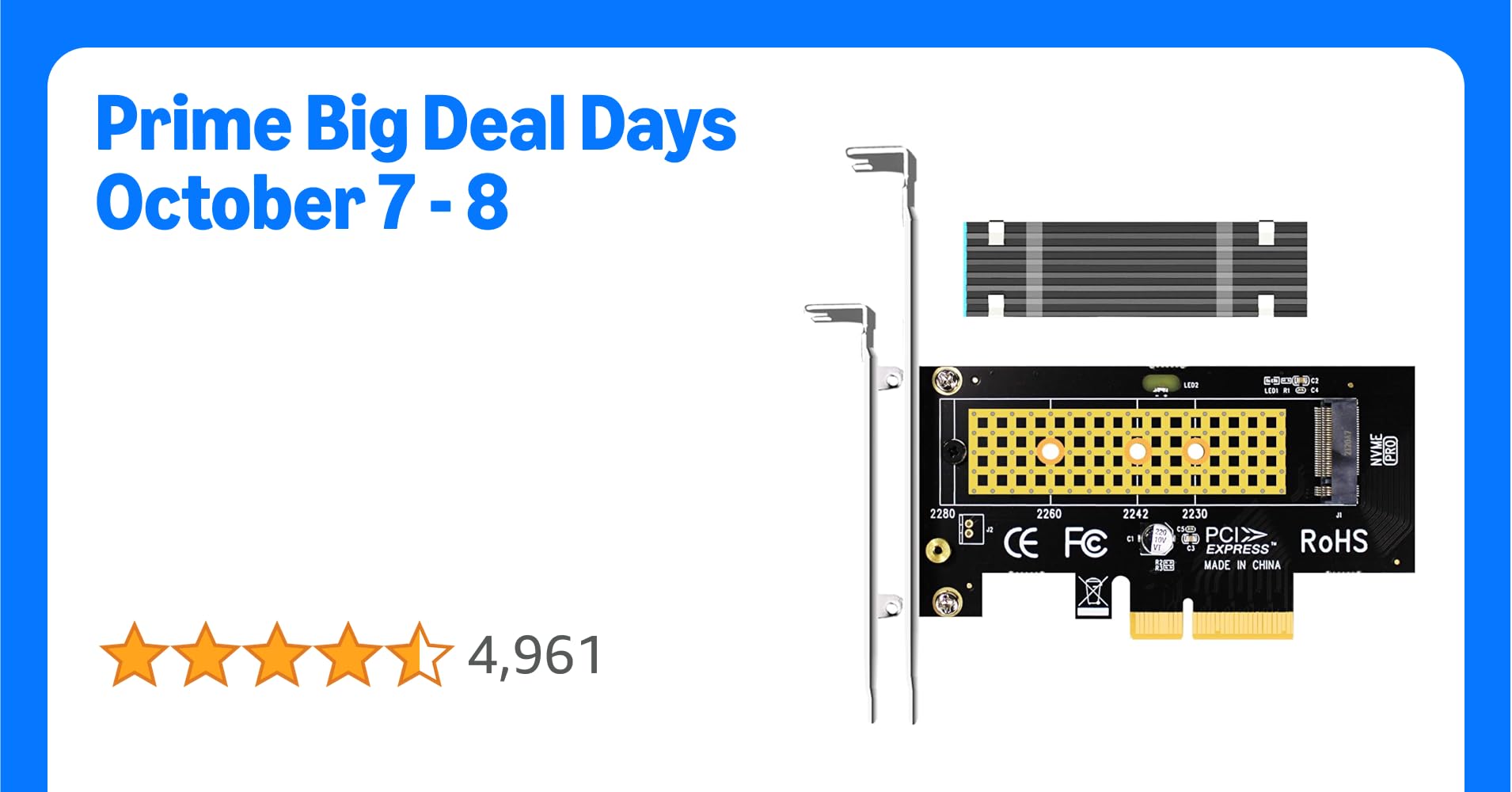

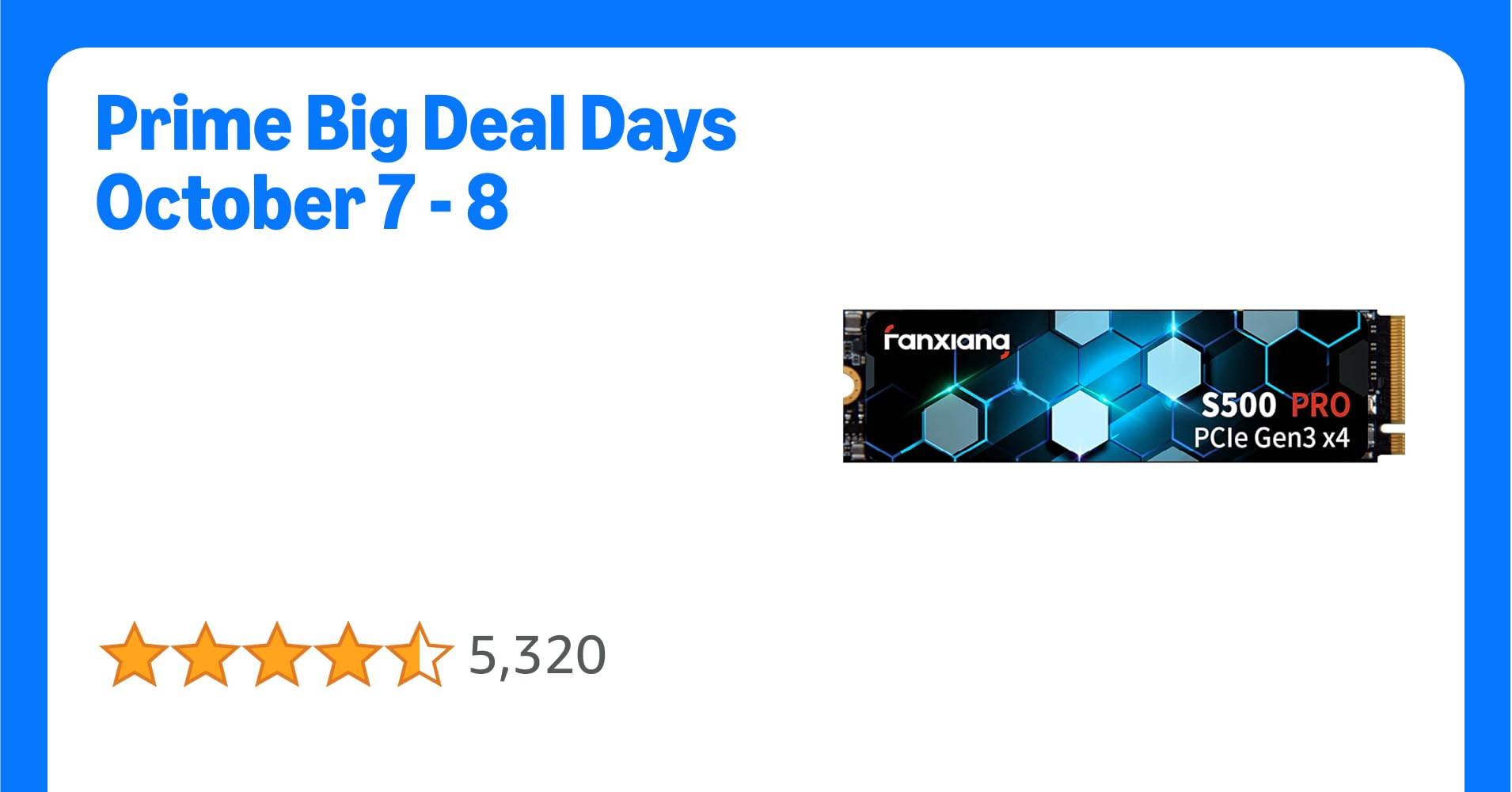

Hi there,
I would like to upgrade my Mac Pro 4.1-->5.1 2009, firmware updated, with an PCIe + NVME.
Low budget solutions.
I found these two products:
Can I boot from NVME?
What actual speeds will I achieve on my Mac Pro?
What do you think?
Are there any criticisms of these two products?
Are there any better recommendations or products in the low price range?
Thank you!
What do you think?
Thank you!
Yes. I'm booting from NVMe. I don't remember which firmware version introduced NVMe support but if you are running the latest firmware I believe you should be fine.
As tsialex said earlier in the thread, you probably won't notice a significant speed increase compared to SATA unless you are doing some serious data transfers to/from the drive.
I have no experience of those two products. Like pdxplm (above) I went for the RIITOP NVMe PCIe Adapter, M.2 NVMe to PCI-e x4/x8/x16 Card. It has been a good, reliable, budget option. It's no longer listed on Amazon UK, I think, but this Sabrent card looks absolutely identical apart from the branding and is only £1 more than the glotrends one:
SABRENT M.2 SSD NVMe to PCIe Adapter with Aluminum Heatsink and Thermal Pad, for SSDs up to 16TB, M.2 NVMe to PCI-E converter 3.0 X4 X8 X16 Card (EC-PCIE)
At least Sabrent is an established brand.
Likewise I put a Samsung 970 EVO Plus in it, also recommended by bookemdano above, and I think widely recommended elsewhere. It's £20 more than the fanxiang card on Amazon UK:
Samsung 970 EVO Plus 1 TB PCIe NVMe M.2 Internal Solid State Drive (SSD) (MMZ-V7S1T0BW )
As far as I know, both the Samsung and fanxiang cards use TLC NAND chips. The Samsung has a 5 year warranty.
