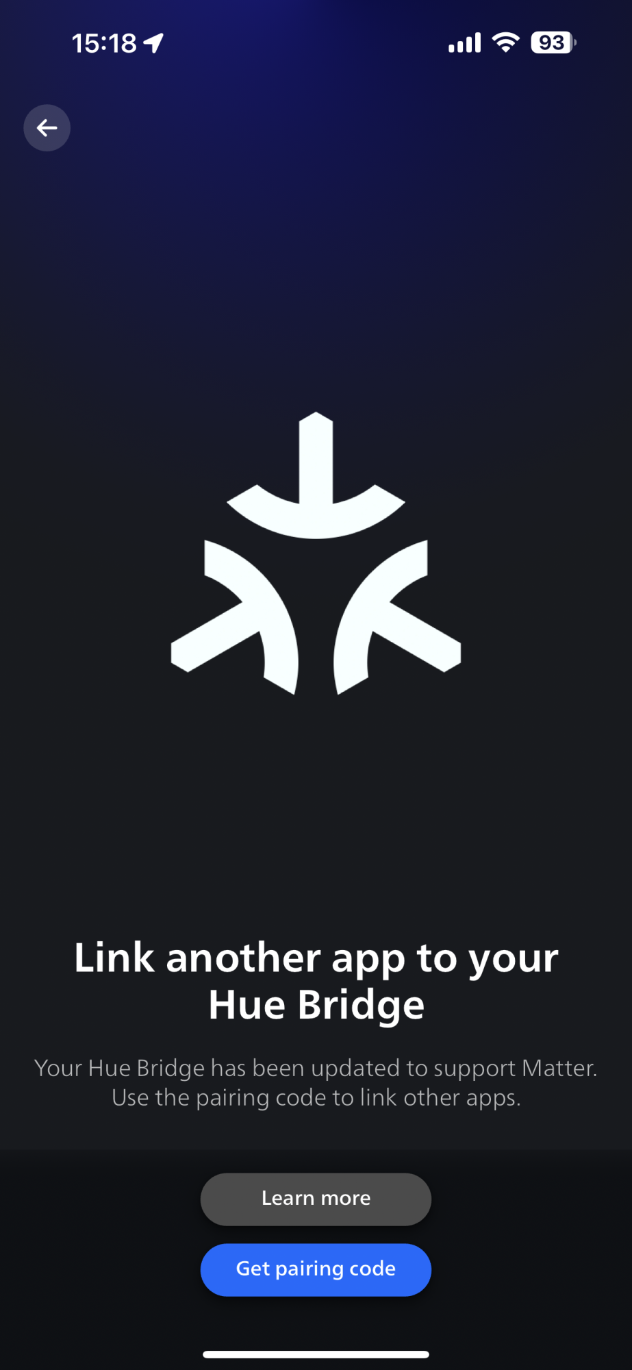

How can I tell if my Hue bridge supports Matter?
What does the article mean by "disconnect your Hue Bridge from your Matter smart home system"? Mine is connected to a HomePod mini. How do I know if my HomeKit is using Matter?
From memory there was an update to the Hue bridge to support Matter. I updated to that although I don’t have any Matter accessories currently.
