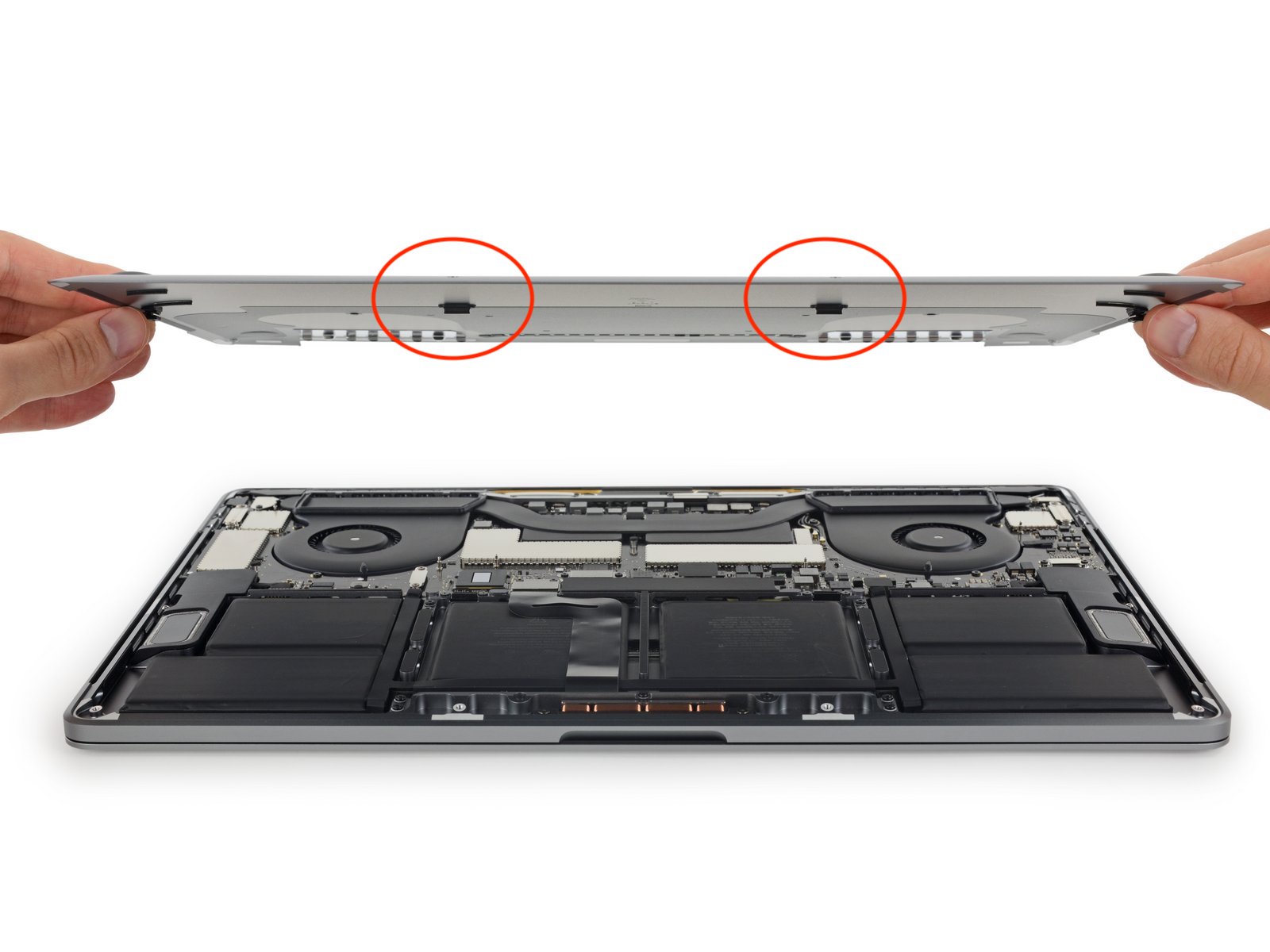

It seems really similar to this:
That sounds an awful lot like the one of the snaps on the bottom panel coming loose (circled in red on the picture), particularly given that you say you can click it back in with a bit of force. Perhaps the mounts pointsthey clip into have gone?.
Ooo, I think you might be onto something. It does seem as if something like that were loose, but would that alone explain things expanding/moving around inside the machine?

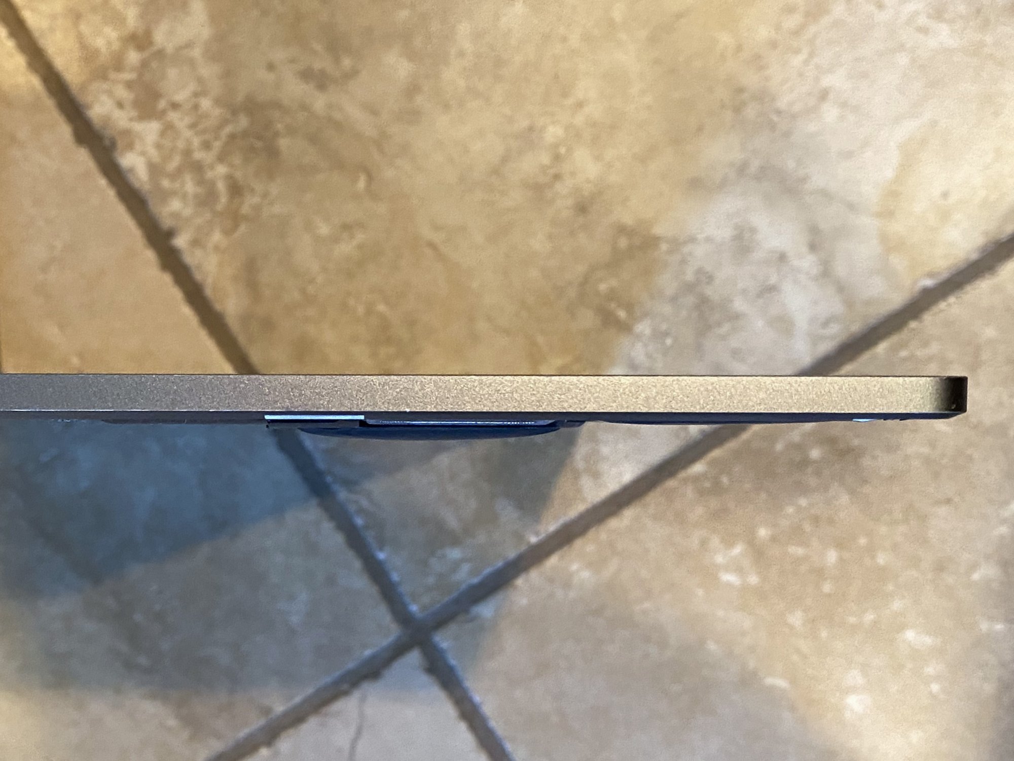

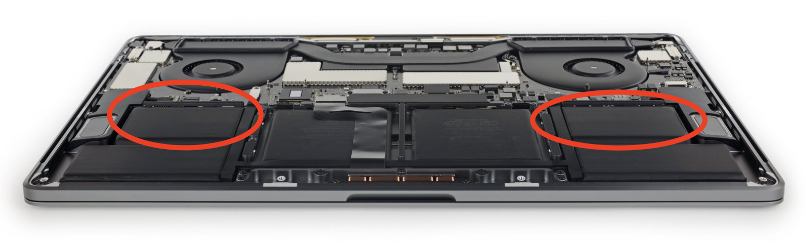

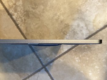

Now that I have the appropriate tools, I decided to pop bottom cover off while the computer was still warm to take a look, and found two of the battery cells were bloated. After a few minutes of cooling they shrunk down to the same thickness as the others.
The "popping" appears to be the batteries pushing against the case hard enough to pop the two snaps (that @TheIguana pointed to) out of place.
I've got another genius bar appointment later today.
Attached:
  • One image circling the two most bloated batteries (The others bloat slightly, but not nearly as much).
  • Another showing roughly how much the batteries are bloating. It's a shot from the left side of the machine, with the bottom case removed.

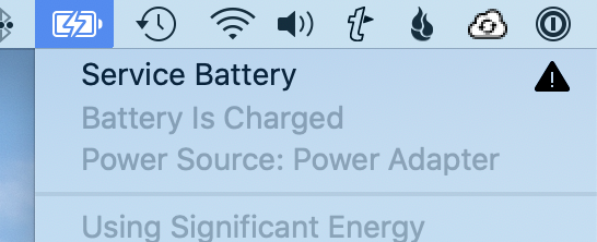

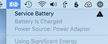

  • And a newer development: A "service battery" message in my menu bar.
