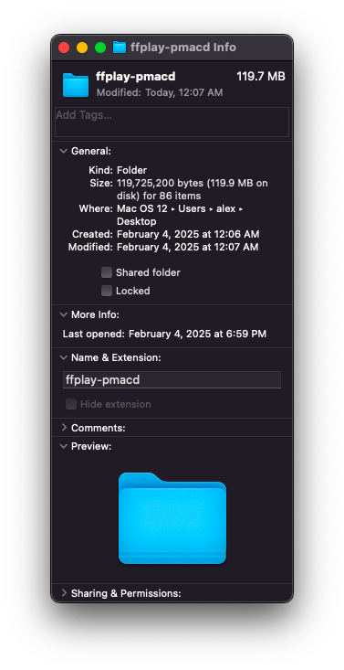

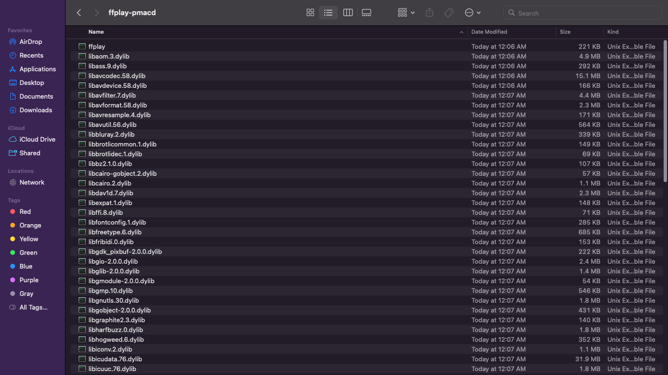

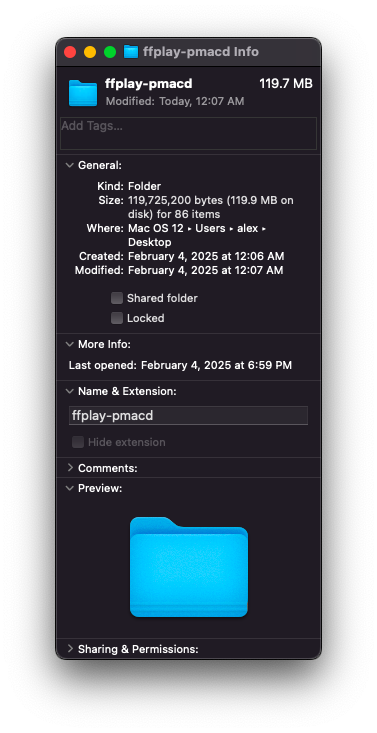

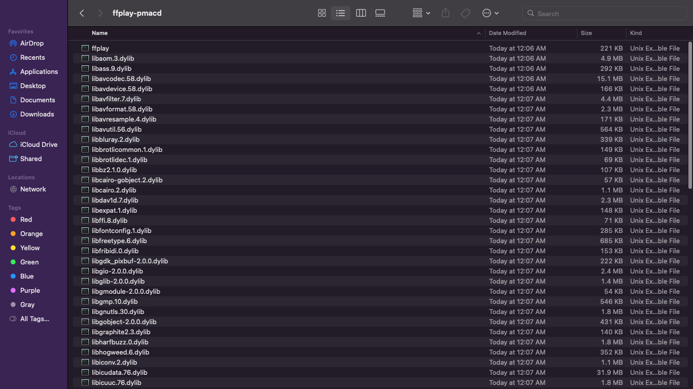

Exactly. There is nothing to 'install' anywhere. It's just like windows portable software where you extract a zip file and you have a folder containing the program .exe file and all the .dll files it needs to run.

It is such a pain to do this manually. This automates everything. Copying the executable into the folder. Copying all the shared library files from their original place into the current folder. Modifying the executable copied into the folder to point to the libraries in the folder containing the executable. Modifying the libraries in the folder to point to the other libraries in the folder. And a bunch of sanity checking and all to make sure it works.
That folder can be placed inside a .app bundle, and then you can configure the app to exec it and not need to worry about anything. That's what I'm doing with Source Engine.app.
The goal isn't really to package existing MacPorts executables in another format (although it is totally capable of doing that). But if your compiling your own software that requires some library like idk libiconv or libcurl and you installed that via MacPorts, and your releasing the software for others to use this is perfect.
