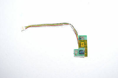

i will buy an light Sensor. I found one one eBay. Is this the right?
Your link shows a left sensor. It appears to be the correct part. But, there are two different sensors. You also need the right sensor, which is Apple's part number 922-5996. That will probably also be on eBay.
You also need a keyboard - part number 922-6105
And, the top case... - part number is 922-6013
I think that is all you need. Good luck finding all the parts. (Viel Glück alles zu finden)
