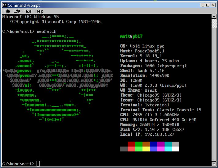

Well, maybe give VoidPPC a shot. It's working on my 17" powerbook. Same specs as yours. See attached image. I honestly hadn't tried any others on this machine, except openbsd, and that worked fine as well.
