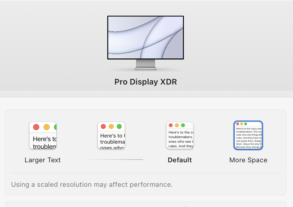

I've got real 6K + HDR + brightness with RX 6600 XT + Dell PCIe USB-C DP Alt Mode adapter card. But XDR is determined as 5K display with 6K as "more space" scaled resolution. I'd like to fix that and make 6K as default

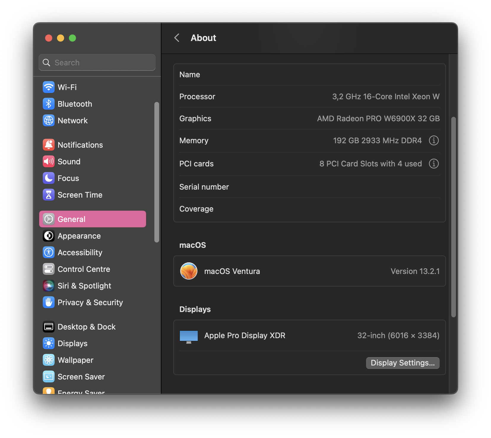

Not possible, I have fight with this problem and gave up. Bought a W6900X, the only way to go native 6K with Pro Display XDR is using an MPX module. If we talking until 5K everybody is sorted. You can use "more space" will look like 6K but is not. Check this tread #77.

It's not "looks like", it's native 6K in my case. I can see the difference between "6K via 5K" and native 6K - it's easy for everyone to see it.
Also I checked AGDCDiagnose output and SwitchResX scaled resolution base - both report 6K. I assume that's because my computer is a Hackintosh with OpenCore boot loader + kexts that make DSC available via USB-C.
Anyway, I get native 6K. The only cosmetic problem is default resolution in settings.

- MPX W6900X delivery 6K native
- RX 6900 XT delivery 5K native USB-C (no power on XDR hub)
bootcamp windows + Pro Display XDR
- RX 6900 XT delivery 6K native USB-C (power on XDR hub)
Can you please share this screen on your Mac?
I'm only showing 5120x2880 right now on Monterey. I haven't used this set-up in a looooong time (I have since moved on to a Mac Studio). Looking back at some of my old posts when I originally had this working, it was with Big Sur.
