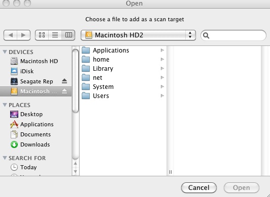

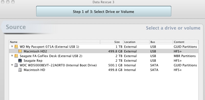

- Than I tried to recover computers data from external clone (500GB in 1TB WD Passport). However, this time my recovery file was a dmg file (D-00001.dmg) instead of recovered and restored files. Additionally, I could not open this dmg file. I tried various mounting programs, but they all failed.
Prosoft customer support, first suggested enabling expert futures then selecting the file to scan in detailed view for deep scan. In my case this was not possible. As seen in 1st picture, the highlighted volume is the clone that I want to scan (500 GB in external 1TB WD My Passport).
In Enabled Expert Features and in Detail View, I cannot select the Macintosh HD2 with Add file to scan selection. The reason for that is computer detects Macintosh HD2 as a device rather than its container WD My Passport, as seen in 2nd picture.
