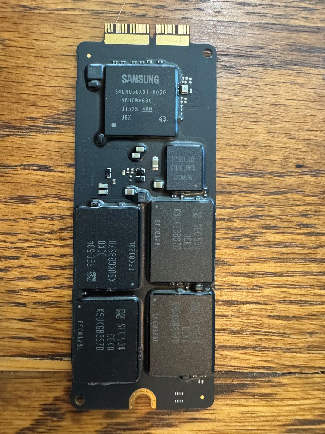

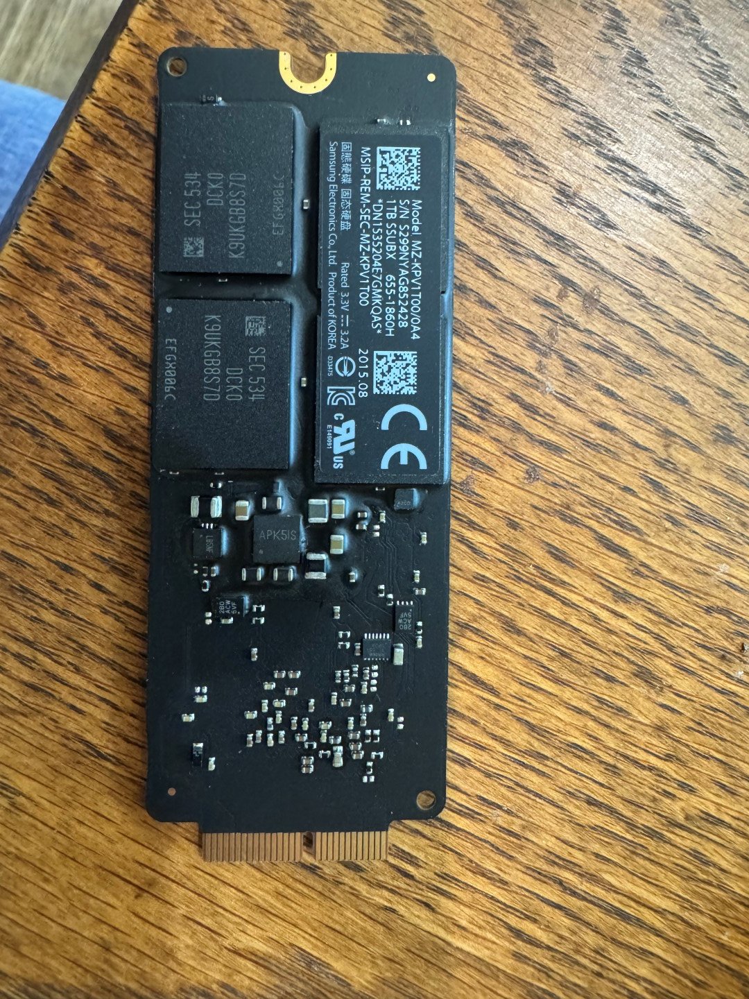

See attached images - can anyone confirm a laptop model that will connect this drive? Or any other data recovery service that might be able to help, if not? Thanks!
OK so man... chatgpt to the rescue. Uploaded a picture and it told me it was a 12+16 connector and that you can buy an adapter on Amazon, so off I go!

Yep, it's a standalone SSD, not part of a fusion drive. Thanks -
Web search for the model number MZ-KPV1T00/0A4 suggests this is from a 2013-2015 iMac or MBP. Here is someone selling them https://beetstech.com/product/solid-state-drive-1tb-655-1860. There are lots of others.
Physically it appears to have a standard connector, but all the sellers describe it as for a MBP. And ifixit says that for a 2015 MBP "This MacBook Pro uses a proprietary storage drive connector, and is therefore not compatible with common M.2 drives without the use of an adapter." So I don't think you will get far with a standard SSD enclosure.
I suggest you try a 2013 to 2015 MBP. Of course, you will need to remove the existing SSD from the MBP so that you can put this one in. So it might be best to configure the MBP to boot from an external SSD before inserting the one you have.
The ifixit guide may be useful https://www.ifixit.com/Guide/MacBook+Pro+15-Inch+Retina+Display+Mid+2015+SSD+Replacement/48251
Caveat: The above is all from web searches and not from practical experience.

I've taken apart 100 iMacs. This is my profession (and yes despite that, I have never once opened an iMac with only an SSD blade, I was just as surprised when I found no HDD in the computer). This iMac has no HDD, only this blade. I've received the drive reader and it cannot read the drive either, so I am sending it off for recovery. Fingers crossed!
Yes, the failure with the SSD enclosure is expected. But, hopefully your recovery team have a suitable MBP for this sort of eventuality. Or they know another way.
The hope was that the problem source was the old iMac, but nope. Given the failure of the drive in both places, no sense in trying a third, so it's going off to data recovery pros.
In the past I've used an OWC enclosure (with some success) to read the flash SSDs.
Personally found it to only work some of the time and had to resort to using a 6,1 trashcan for SSD access.
