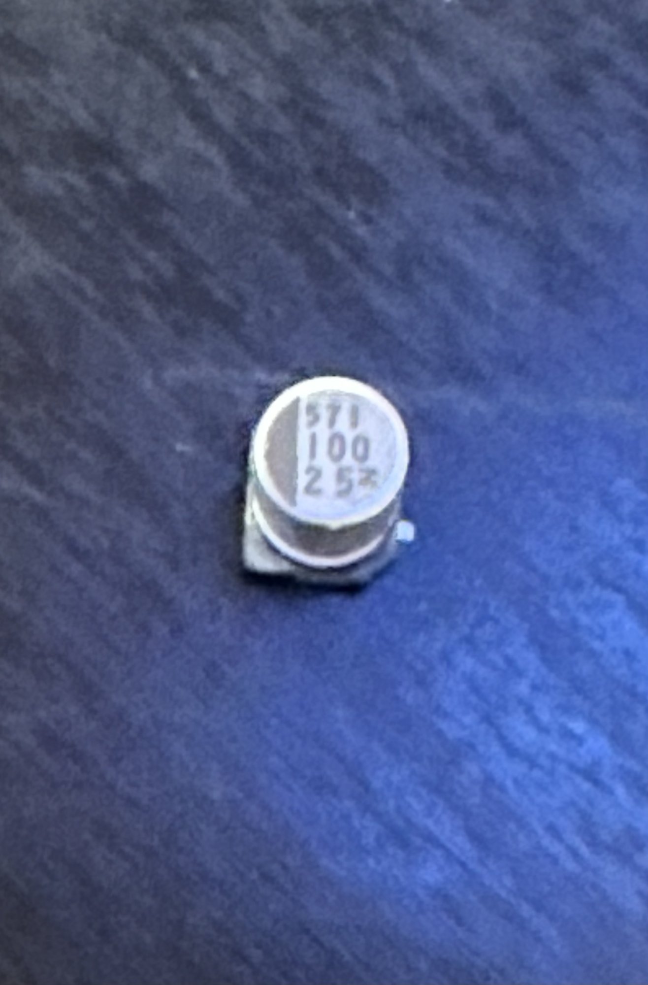

Slight update...I got the system to boot again to a desktop after being off for a few days, but just for a few seconds before the system randomly went to sleep and then wouldn't go back to a desktop after waking it up. When I was poking around inside the system before booting it back up, I heard something loose inside and, sure enough, a capacitor fell out:
I suspect it came off the graphics card, as there is a matching capacitor with the same numbers on it, and there's a spot on the card that looks like where the capacitor should be. It's not the stock card that came with the Late 2005 G5s, but some sort of "EVGA" card that has two DVI ports and an S-VIDEO, not a card I've ever seen.
So it would seem that that is where the issue might lie. HOWEVER, once again, if I put in the GeForce 6600 from my DC-2.3 G5, which works perfectly in there, the screen stays black and the system won't boot.

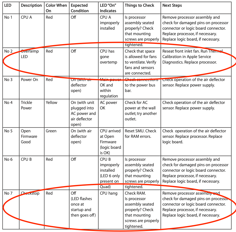

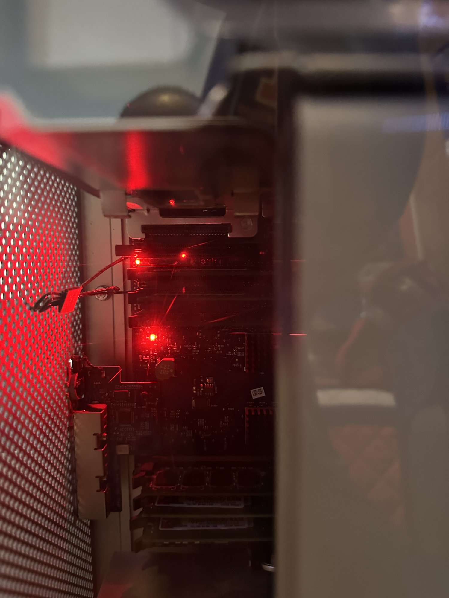

Another update...pretty sure the issue lies in the CPU module...
Looks like LEDs 2 & 7...
Hopefully just reseating the CPUs will do the trick. Will try to tackle it this week once the new RAM I ordered arrives too.
Reactions: NikolaPPC
