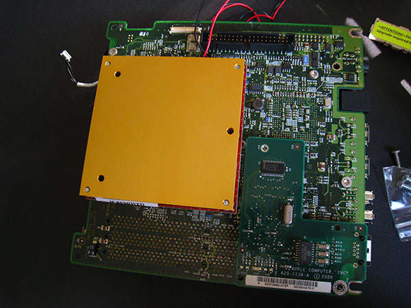

It is definitely possible to use that CPU in a Cube with the original Apple Cube heatsink. As I mentioned, that same aftermarket CPU card was sold for use in both the Cube and other desktops, with the main difference being the supplied aftermarket heatsink. If you search, you can find stuff like this:
Which I found here: https://www.ilounge.com/index.php/backstage/comments/the-cube-project-part-3
So you can see that to use that CPU in a Cube with the original Apple heatsink you just need a suitable plate between the CPU and the Apple heatsink.
