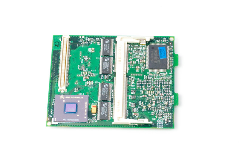

The difference is that the RAM sockets are built into the processor card on the PB G3.
The difference is that the RAM sockets are built into the processor card on the PB G3.View attachment 2575851
Not all the RAM sockets are built into the processor card on all Powerbook G3s.
This guide points out that on the Lombard one RAM slot is not on the processor card. https://lowendmac.com/2008/upgrading-your-lombard-powerbook-g3/
It still seems as though the method outlined by dosdude to add more RAM should work with only some adjustments - that mod was done on a G4 upgraded Ibook G3.
The Wallstreet/PDQ, Lombard and Pismo have a second memory slot on the bottom of the processor daughtercard. There is no soldered-in-place RAM on these models. The "Kanga" G3 and the 3400C have soldered RAM along side an additional user-accessible memory slot.
The article you're referencing mentions this in Step 7 (remove daughtercard) and Step 8 (remove and replace memory module).
