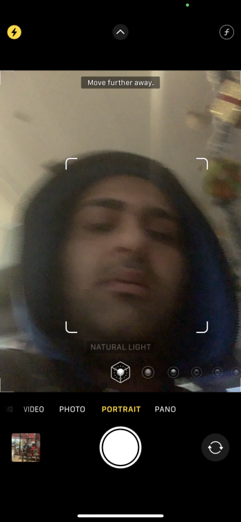

But I have this message and I wonder if something happened to the dot projector. But nothing touched it.
At portrait mode I have this move further away and the square thing follows my face
I don’t think the dot projector has a problem. But I want to make sure

Yes the TrueDepth camera is using dot projector. When I use portrait mode it says move further away. For that kind of message it might come from the flood illuminator not functioning due to the ripped earpiece. But that’s my idea and only idea for it.
I want to determine if this missage including the “a problem was detected with the true depth camera. Face ID is disabled” is from the dot projector being faulty.
