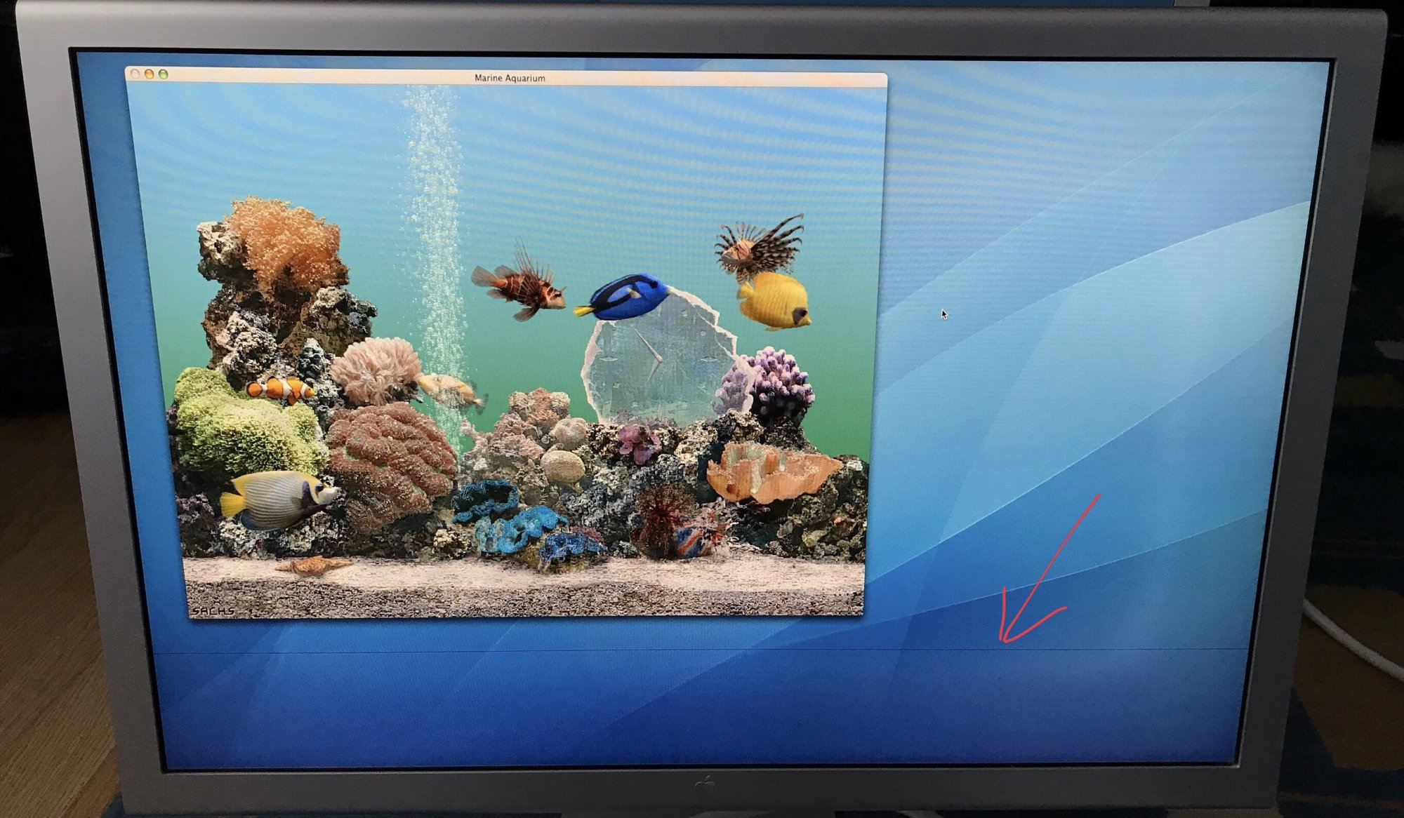

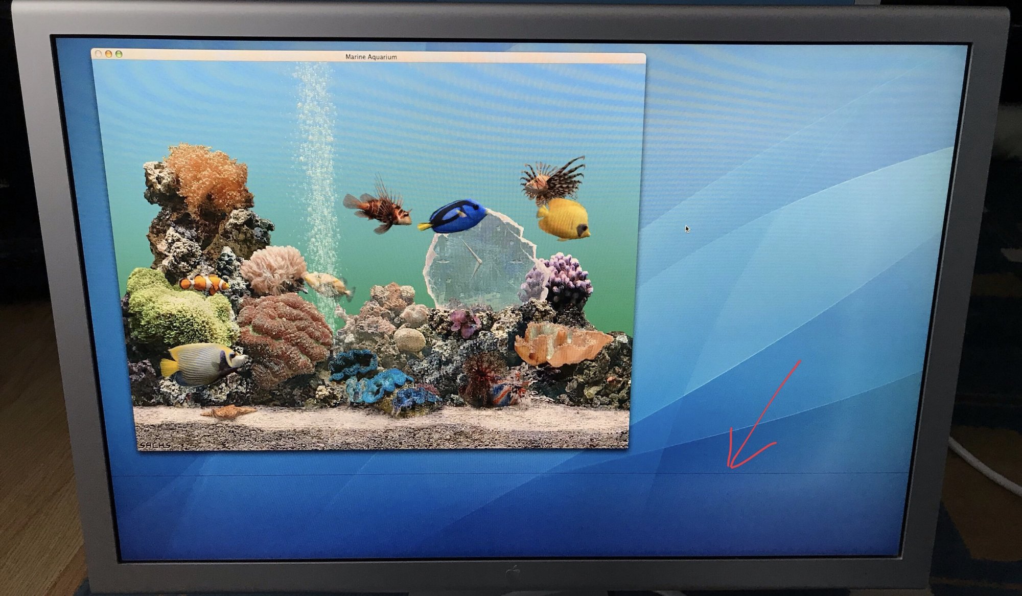

I too have one of these displays (currently in it's box).
A number of years ago it developed a single back line of pixels horizontally across the screen.
The screen/box are mint and can't bring myself to just throw it away....:confused:
I have searched high and low online to try and find a cause/solution with no avail.
It drives me crazy, as it's a beautiful screen.
Yeah, in this case it's the screen. The pixels have gone bad, just like you'd find with a laptop screen. In your case, all you'd need is a new screen.
I wonder if it could be a faulty connection or cold solder point. My 22” DVI has a vertical red line — but it doesn’t always show up.
This is the thing, if I could find a specialist to look at it, it may be something simple.
Originally cost me £900 ish to buy.
Reactions: TheShortTimer
Going on personal experience, it might be easier to swot up on the basics of electronics theory and electrical engineering and then look at it yourself. I spent ages trying to enlist engineers to look at stuff but no avail and in the end I took matters into my own hands and after a bit of practice I became proficient enough to tackle repair projects myself.
If it is just a cold solder point aka "dry joint" as @Amethyst1 speculates then that would be very easy to correct with the right soldering equipment. Also, we're reaching the stage where it's worthwhile acquiring the skills so that we can maintain our beloved hardware without reliance on others.
