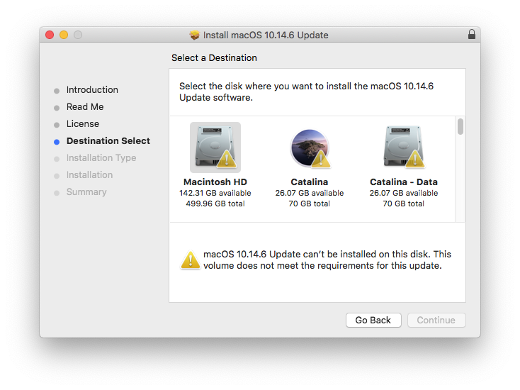

OK, thanks. I'll do that then. When I run the 10.14.6 combo update I get the following error message:

You can't install a combo update for Mojave over the top of Catalina.
My main OS is Mojave, which is on the Macintosh HD disk you see in the picture. That's where I want to do the reinstall. The Catalina install is on another disk. I have several installations of both Mojave and Catalina on different volumes and/or APFS containers on two different disks. The problems I'm having with Mojave seem to have started once I installed Catalina (on a different partition).

You also can't reinstall a combo update over a version of macOS that's had security updates installed, so that's probably what's going on there.
OK, thanks, that sounds plausible.
