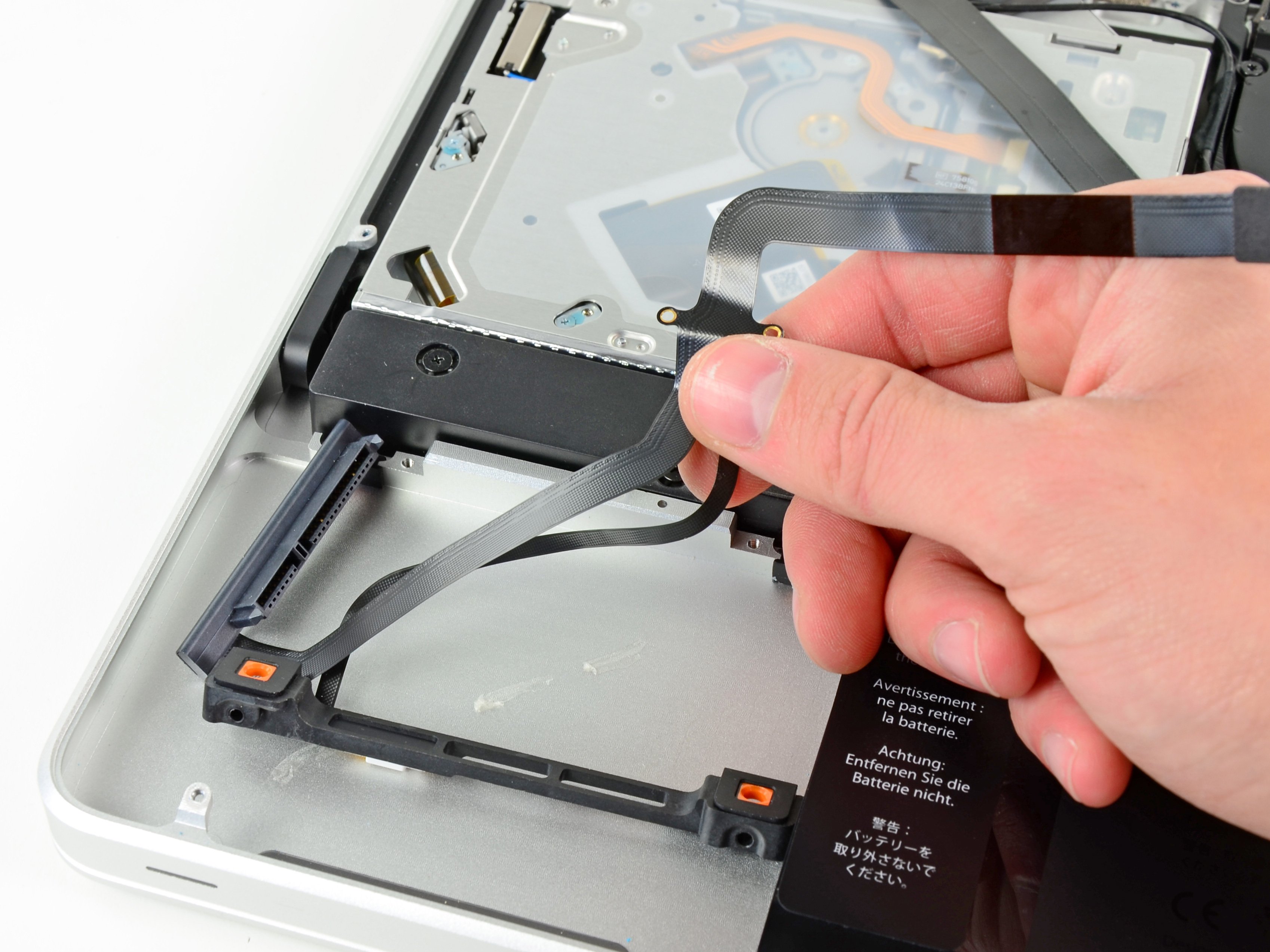

I can't find anyone to do it for me....so after watching the "how to vids"...I am sure I can do this without to much problem -old hands old eyes considered, and no hurry, my mbp is currently slow to the point I am no longer going to tolerate it-
folks on this site have suggested a new SATA cable. to speed it up-but as long as I am going to do that I will want a new SATA cable a new battery to replace the old one, replace current hd with an SSD and finally an SSD in place of the cd drive. and maybe a USB housing for the cd drive USB
-I probably could buy a good used mbp for what I am going to spend-
but if mine upgrades as I intend, I will be happy, it is a backup to my iMac but is currently so slow it is impossible to work with.-

Great teardown guides on iFixit
They even sell the cable you're looking for.

Thank you, common sense also says the cd drive replacement would provide not much in the way of performace not sure why.....just seems out of the permformance loop to me..the more I consider it I think I will do the sata cable only first.....then see what if anything that has done for me--
sllllloooooowwwwww browser to browser page to page load speed.....I have a 1tb ssd that I boot from so it boots up ok....but I think it still uses the 750 gb spinner hd for other stuff......so that is likely part of the slow problem.???!! truth is I dunno--
guerss! trial and error is my appoach - and ask you guys
