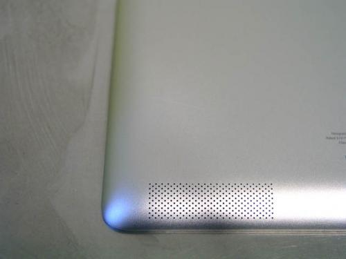

Attached are two pictures. I took a shot of the iPad before either treatment and adjusted it to be about exactly how noticeable the scratch was before the treatment (it was still under the ArmourSuit at that time). Keep in mind that this shot was angled intentionally to maximize its visibility. I then took another shot after both treatments and at the same angle. Again, I adjusted it slightly in Photoshop to match what I am seeing now (and again the shot is worse than real life - by a long shot).
I think the results shown in the picture pretty much speak for themselves. Now most people would not even be able to see this scratch without being told where it is. I would say the two steps were a 100% successful since I did not think I would be able to reduce the scratch that much given what others were saying online.
Conclusion: you CAN remove iPad back scratches if you really want to!
PS - The left picture is the before shot (of course). In the before pictures, there is a piece of white cat hair on the far right, not a scratch. See what a difference! "
Before
After
Before
	After
