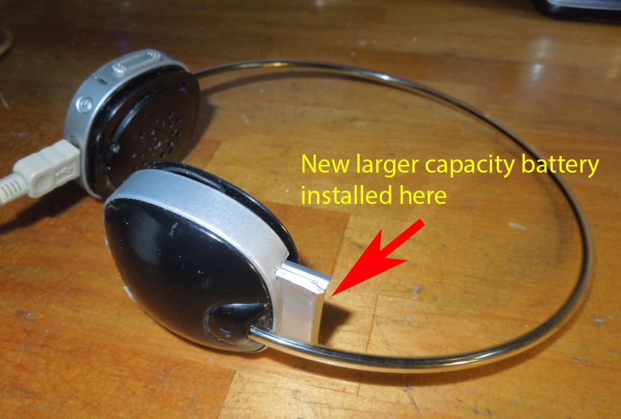

I have three Sanwa MM-BTSH30 headsets( I teach English over Skype in Japan.
https://www.sanwa.co.jp/product/syohin.asp?code=MM-BTSH30BK.
The recommended retail price is around ¥8,400 but I got mine for around ¥3,000
They come in Pink & Black and for some reason the Black ones seem to have a longer battery life.
The stock battery is rated at 3.7 v 320 mAh
In any case I must always have one set charging or on standby.
One of the Pink headsets developed an obvious electrical fault so with nothing to lose I hacked in a 2000 mAh battery and . . it works now with some limitations = can't change the audio level but that 'could' be my fault during the install. still, I am getting well over 24 hrs continuous use now and probably will be able to fix the lack of audio volume control
Today, my main Black set lost charge after 30 mins operation so I whipped down to my loacl electrical store and got a 3.7v 860 mAh battery. I had to cut a small section out of the right phone cover to allow it to be seated. I charged it up and it's working great ! Tomorrow I'm going to buy 4 of these batteries for future use.
Hint. . . . If you plan to install a larger capacity battery ..
1. Open the headset/phones very slowly & carefully . .. the speaker wires are delicate !
If you're lucky your headset /phones will have a socket which will make it a 5 minute job.
2. Photograph ALL the connections.
3. I have seen warnings on the net .. not to go over 2,000 mAh capacity batteries.
make sure that your replacement battey is teh same voltage. . mine are all 3.7v
That's it.
