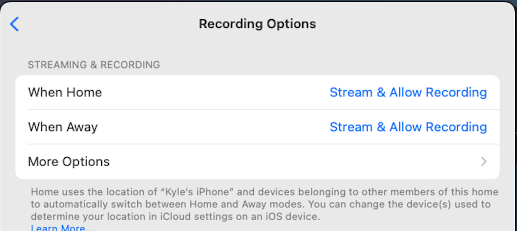

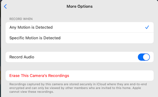

I setup my front door Eufy camera to do the equivalent of 24/7 recording in HKSV. It's not a perfect 1:1 but it does the job.

Not at all the same, since you're relying on HKSV to detect motion for a clip to be saved. Yes you can view the stream any time, but if you scrub through the history there will be gaps. I've had plenty of issues in the past where there was absolutely motion in the video, but not enough for HKSV to detect it, so the clip was not saved. Or the motion was not constant. For example, a deer walked onto my driveway, stopped and looked around for a solid minute and a half, then walked away. The deer was standing still while still moving its head. HKSV only saved clips from when it was actually walking. Now apply that to someone messing around with your door. They walk up to your door, hunch over the lock while they try to pick it, then either leave or get in the door. You want HKSV to save that entire event. I don't have confidence that it would.
