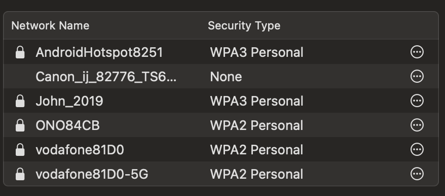

My MG5350 canon printer is reading 'Full absorption pad' and I am trying to reset the counter to zero. I can get the printer into service mode and I've obtained the service tool via Virtual Box and Windows 10. The service tool page opens OK but it won't recognise the printer. I think this may be because I have the printer on both USB and wi fi and so I need to take it off wi fi. I have the list of wi fi on my Ventura Mac but I'm not sure which to delete. I'm assuming that it is WPA3 Personal, so would it be the one named John_2019?
The list shows the routers wi fi - Vodafone, and my other printer, the TS. How do I find out what the others refer to?
They are my networks - I just don'y know to what they refer. One must be for the printer, but which one?
You need to look at your printer's documentation to determine what network it's connected to. You can't determine this by looking at the list of available networks.

I followed your instruction and presses the resume button but it only flashed eleven times.
OK - I have the network settings, which I got from the Canton utility tool. How to I disconnect the printer from wi fi?
Thanks - I found it in the settings menu on the printer screen. Wi fi is now disabled. Now to see if the tool works!
