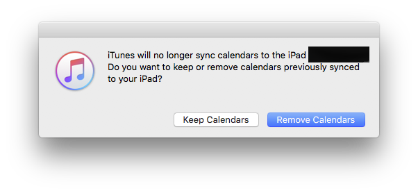

I've tried to sync the iPad (actually both of them) by first deleting all Calendar and Contact entries (deselect the "sync" button for said apps in iTunes on the Mac prior to syncing), synced, then physically disconnecting the USB cable, reconnecting and re-syncing again, only to see the same entries (which aren't supposed to be there) are still present.
