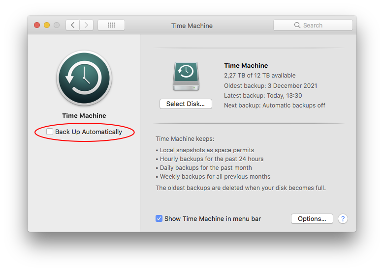

4) Attach the external Time Machine drive if you haven't already. Go to the Time Machine icon in the menu-bar (or to System Preferences in the Apple-menu and select Time Machine there).
Be sure to turn off (disable) "Back up automatically" as we don't want it to create new backups now (I suppose it might confuse Time Machine, take a long time to do, probably be unnecessary as we haven't got any new files to back up and might even mess things up).
You may also have to select the Time Machine disk if it isn't already selected (press the "Select disk..." button).

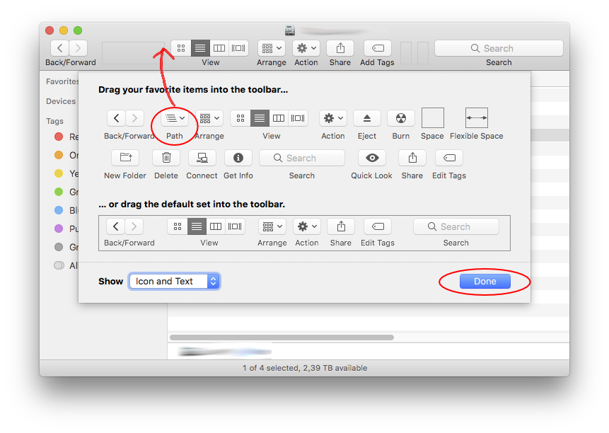

5) If you haven't already done so, now is a good time to enhance the Finder windows by adding a "Path" button as this will allow you to faster and easier navigate on the drive in question.

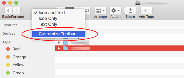

So open up a Finder (desktop) window,
... then right-click in the top area (where the buttons are)
... and select "Customize toolbar":

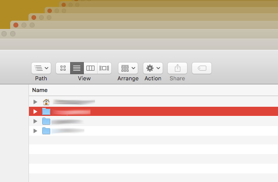

6) Next, drag the "Path" icon to where you want it in the Finder window, then press the "Done" button:

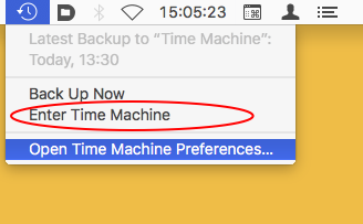

7) Next, click on the Time Machine icon in the menu-bar (provided you've turned on the "Show Time Machine in menu bar" option as shown in the screenshot of step 4), then select "Enter Time Machine".

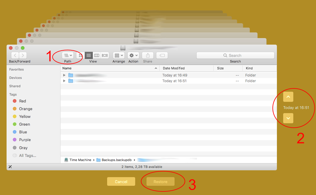

8) Having entered Time Machine you can now restore any individual file/folder. And as I found out; this also includes restoring an entire user's "home" folder! :)
I decided to try all of this with the least important Home-folder on that Mac, just in case something went wrong.
So, once having entered Time Machine which shows you a stack of folders...
... click on the "Path" button
... and navigate till you find the location of all your users
... then select the Home-folder of the first user you want to restore (don't open it, but just select (highlight) the actual home-folder as this will restore that user's entire Home-folder).
... choose the backup date you want to restore from (in my case I didn't want to risk using the very latest backup as I was worried it might have contained partly corrupted files because my hard drive was starting to malfunction, so I choose a day before that. Your mileage may vary as they say), then press the "Restore" button to restore it.
... You may need to select the path of where to restore it to (in which case you select the location on the new hard drive where that user's home folder was found).
