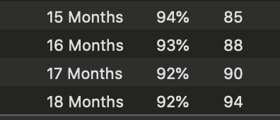

I started charge limiting around the 2nd or 3rd month after purchase. As you can see, the battery capacity remained at around 100% until the 15th month (85 cycles at that point). Currently at the 18th month, it seems the capacity has stabilised at 92%.

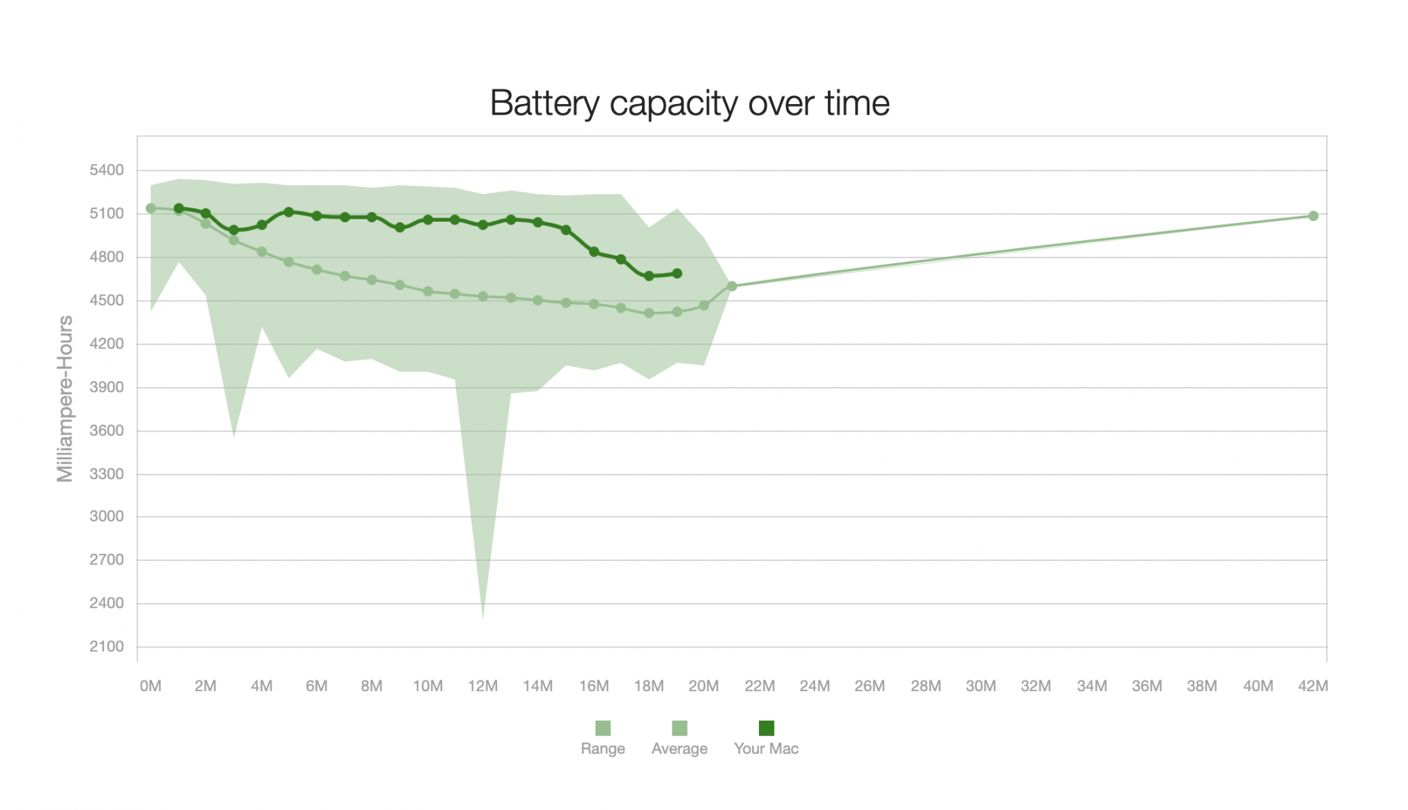

Here is a coconut battery graph comparing my mac to the average:
As you can see, it is possible to prolong the drop from 100% with about a year. By the very minimum, this can increase the resale value as you can use the machine during that time and sell it after a year before capacity drop has begun happening. For personal usage, I see no drawbacks as this prolongs the battery life across the machine's life, and reduces stress by mostly using it at around half charged capacity and rarely going to full or empty state. Doing complete empty-full cycles only serves a purpose to maintain calibration of the battery, so that you do not end up sitting at 50%, while in reality you sit at 20%. If you do not recalibrate, at one point your machine will shut down itself when you seemingly have (for example) 20% left. If you encounter this issue, a few deep cycles are required to recalibrate fully (it took me 3 complete 0-100 cycles to resolve this when it happened to me). That's the reason I just spread out the full cycle between every 2 weeks, or so.
