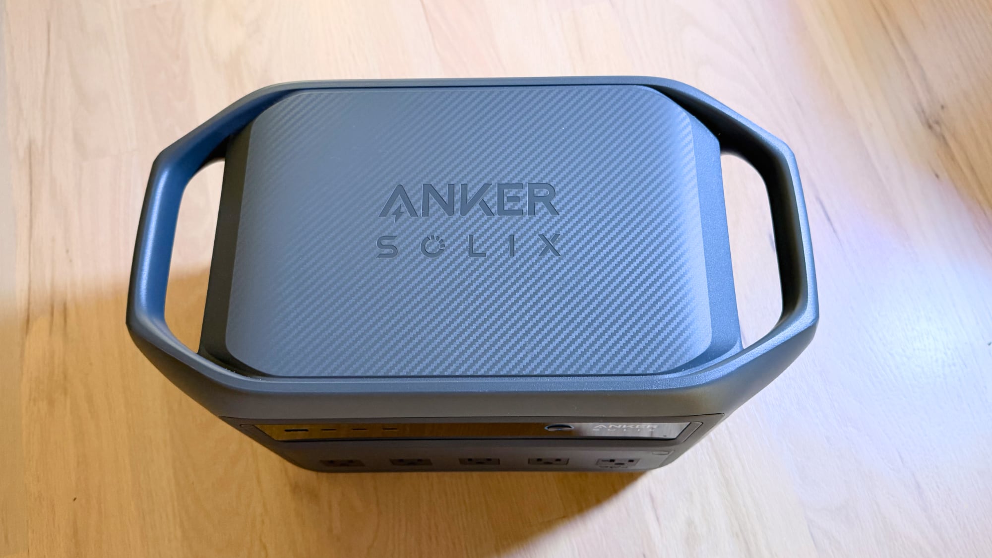

Anker is well-known for its charging accessories, including the Solix line of high-capacity power stations. Earlier this year, Anker came out with a new Solix C1000 Gen 2 Portable Power Station, which I've been testing for the last several months.
The C1000 has your standard power station aesthetic, made from durable black and gray plastic. It has two handles at the sides, which makes it simple to distribute the weight across two hands, along with fan grilles and an LED display that shows the current power level and the power draw of anything that's plugged in. Rubber feet at all four corners ensure that it remains stable.
There's no revolutionary design here, but the Solix C1000 looks and feels rugged. Curves at the corners make it feel a little more modern than some other power stations, and while it's not waterproof, you can get a protective carrying case that keeps it safe from moisture. It's 25 pounds, so it's probably not a battery that you're going to want to be lugging to the beach or the park, but it is good for all-day power if you're in a location where dragging around 25 pounds isn't a hassle. It isn't overly large, measuring in at 15 inches by 8.2 inches by 9.6 inches.

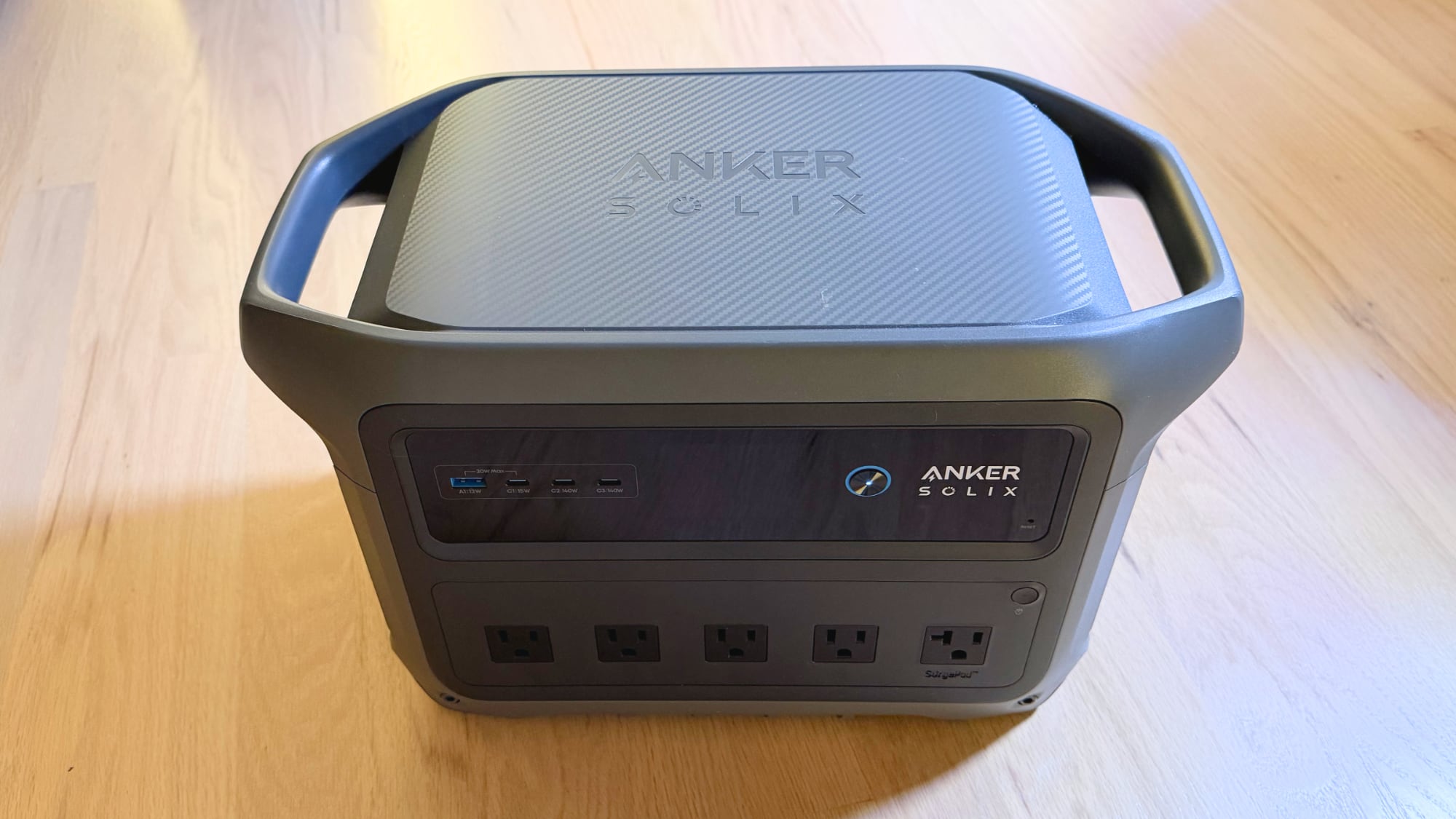

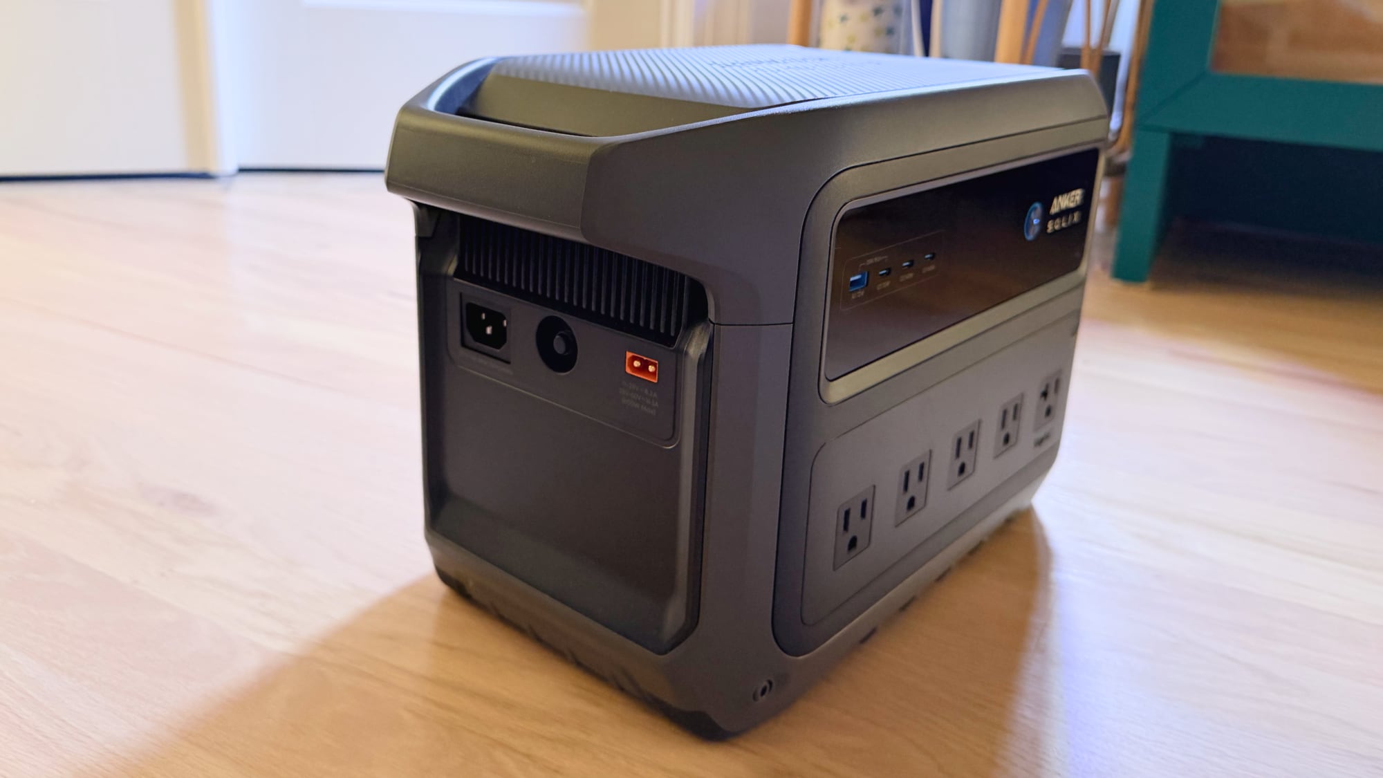

At the front, there are five AC outlets, two 140W USB-C ports, one 15W USB-C port, and a 12W USB-A port. I appreciate that Anker is phasing out USB-A and only included a single USB-A port, because USB-A connectors are growing more uncommon. In the future, you may have no USB-A devices at all, so you won't have several wasted ports. 140W USB-C should also be good for years to come. There's a charging port at the side, a solar input port, and a 12V car port.
I like the port arrangement, and was fine with all of the AC ports on the front, but spacing could be an issue if you want to plug in multiple devices with large plugs. For the AC outlet, you need to turn on AC power manually, a feature that exists to prevent battery drain when idle.

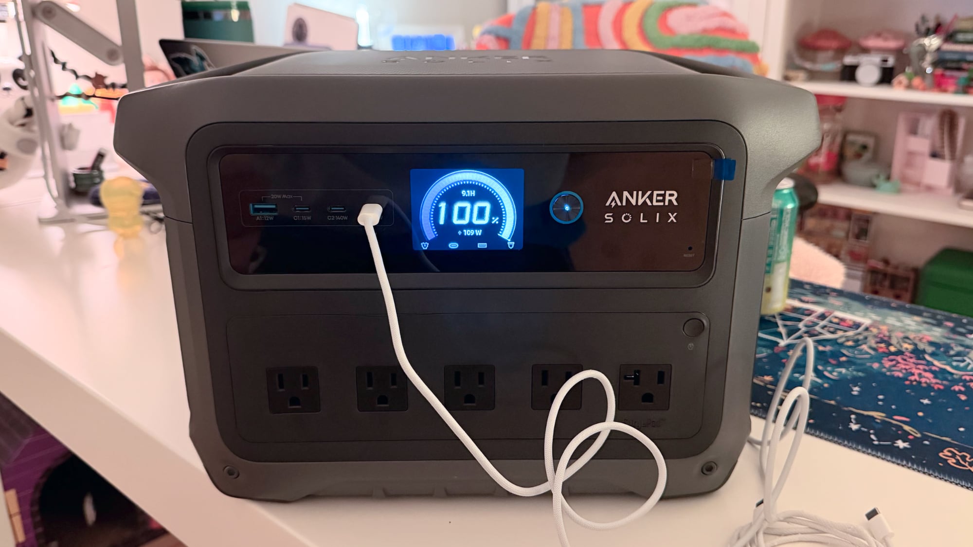

The C1000's 1024 Wh capacity is enough to charge an iPhone dozens of times. Charging my iPhone 17 Pro Max from 0 to 80 dropped the battery level from 53 percent to 51 percent, which is only a two percent hit. Subsequent testing consistently used between 2 and 3 percent for iPhone charging.
You can get fewer full MacBook charges, but it's still enough to keep multiple people up and running for a couple days. Charging my MacBook Pro from 0 to 100 percent dropped the battery from 100 to 88 percent, and charging my MacBook Air from 0 to 100 percent dropped the battery from 100 to 90 percent.
It was able to run my MacBook Pro for a full 8-hour work day, doing day-to-day tasks like writing. I started at 76 percent and ended at 57 percent. It lasted almost 24 hours running my full Mac setup, which included my MacBook Pro, Studio Display, three LED lights, and a phone charger. That does include around 10 hours of time where the MacBook and display were in rest mode, but it is more than capable of supporting a full work setup for a day or two.
What's great about the C1000 is that it tells you exactly how long it will last based on the power draw of what's plugged in. On the LED, you'll see an estimated readout. It predicted around 14 hours of usage for my 67W MacBook Air, which was accurate.

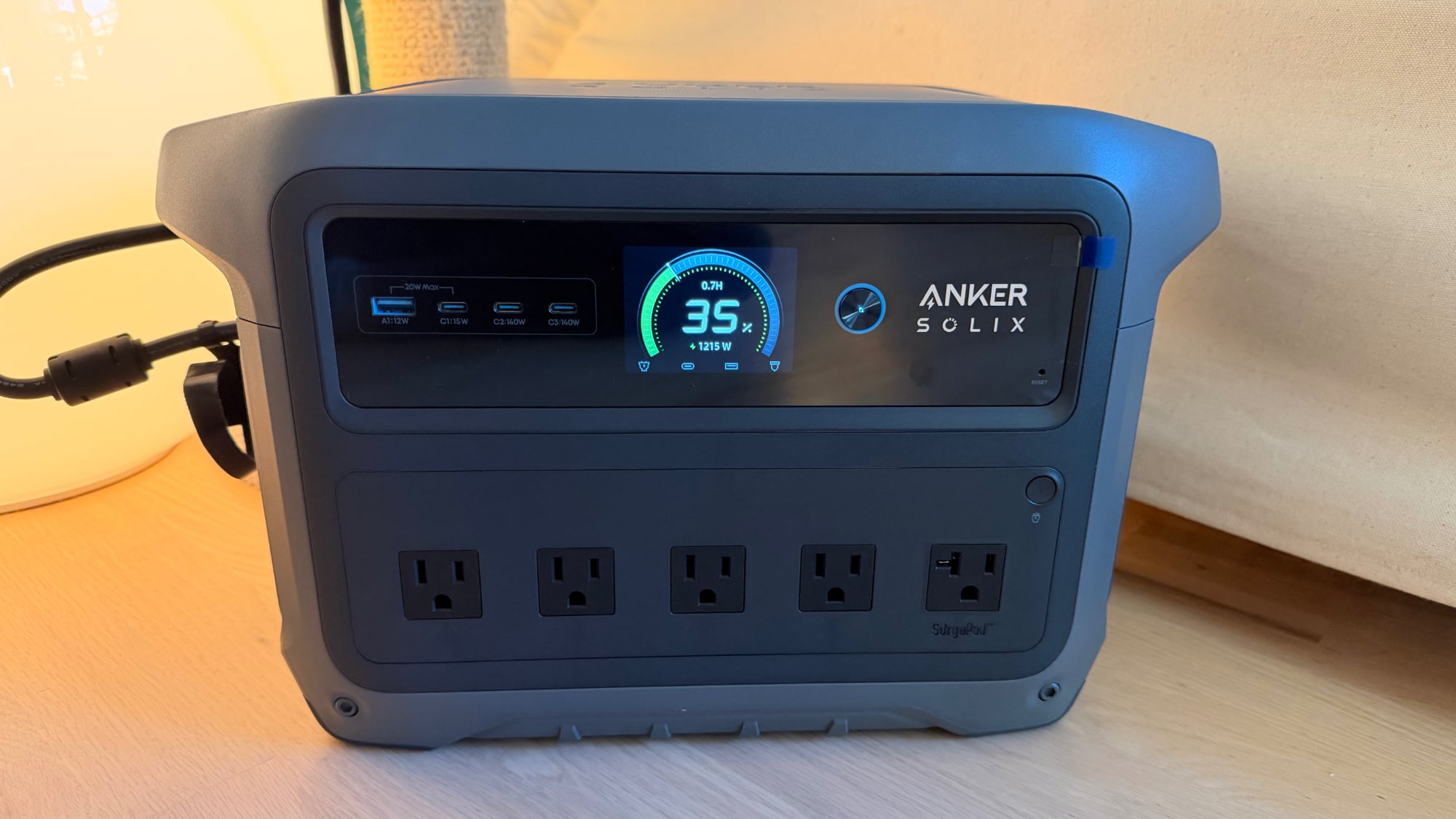

The C1000 is able to charge quickly, which has the potential to be useful when you're in a hurry. It can recharge to full in 49 minutes from a standard household plug, drawing around 1200W to do so (Anker says it can go up to 1600W, but you need to enable it). When it is under that kind of load, the fans kick on, and the fans are loud.
I wouldn't be able to sleep with the fans on that high, and it's definitely a loud, irritating fan noise when going full blast. Luckily, the fans only come on at that level when it's under heavy load, and charging doesn't take too long. It also can't run high watt devices for super long, and it's much more tolerable at lower power levels. When charging small devices, it's near silent.
You can connect the C1000 to a car or to solar panels to charge it up. For solar, charging times vary based on the size of the panel, the number of panels, and the available light. It can accept up to 600W through the solar input.
