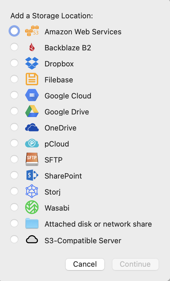

It is pretty easy. Just go to Backblaze B2 and setup an account then create a "Bucket" to store your Arq backups.
Then add a new storage location in Arq and in this screen pick B2. Then you enter your B2 credentials and select the Bucket (essentially a folder on the B2 server) you created earlier.

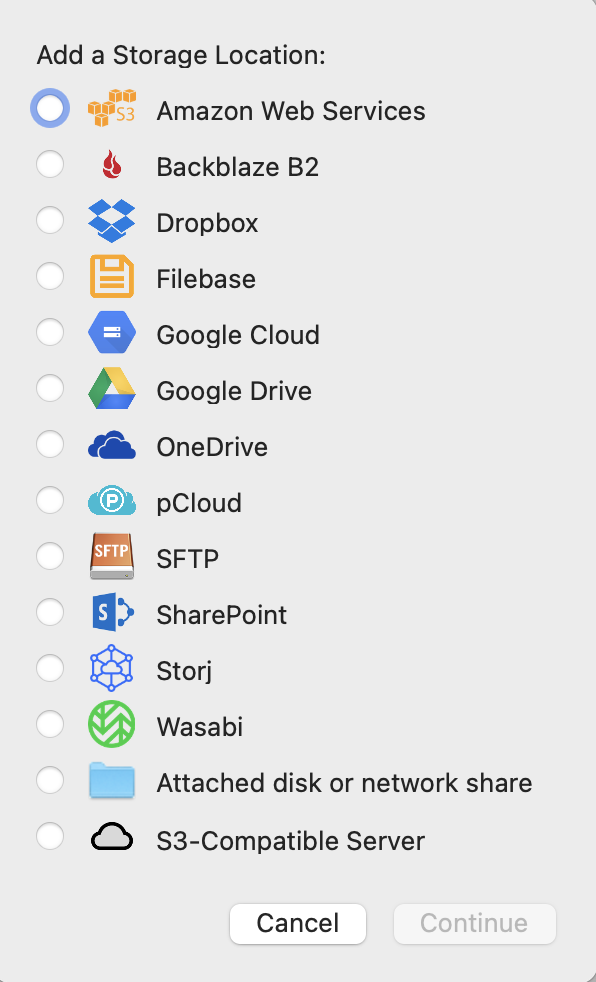

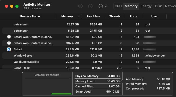

One thing I've found is that backblaze (personal version) will devour massive amounts of RAM - basically everything you aren't using. For example, this is what I saw this morning. It will free up some of that automatically when you open another app, but more than once I've gotten an out of memory error from backblaze. Some discussion here.
However, my computer usage is unusual, I create huge intermediate files (300gb or more sometimes) and then delete them later. I also export millions of small files at times, last weekend I created about 5 million, for example (I make maps and these are image tiles). Eventually I should find a better solution for this, but for now I just disable backblaze when I'm in the middle of a project, then set it back to automatic when I'm done.
But again, mine is just the standard personal backblaze installation, shouldn't be a problem if you're using B2 with another software package.
