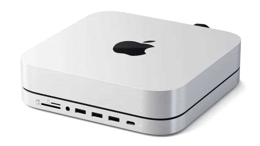

One more thing: several places make a same-size (as Mini) docks with built in storage. You might want to get one of those and a good amount of storage as a permanently-connected drive...
Unlike the typical portable enclosure, there should be little to disconnect that drive and that thing can easily come forward to your next Mac Mini (or Studio) purchase too.

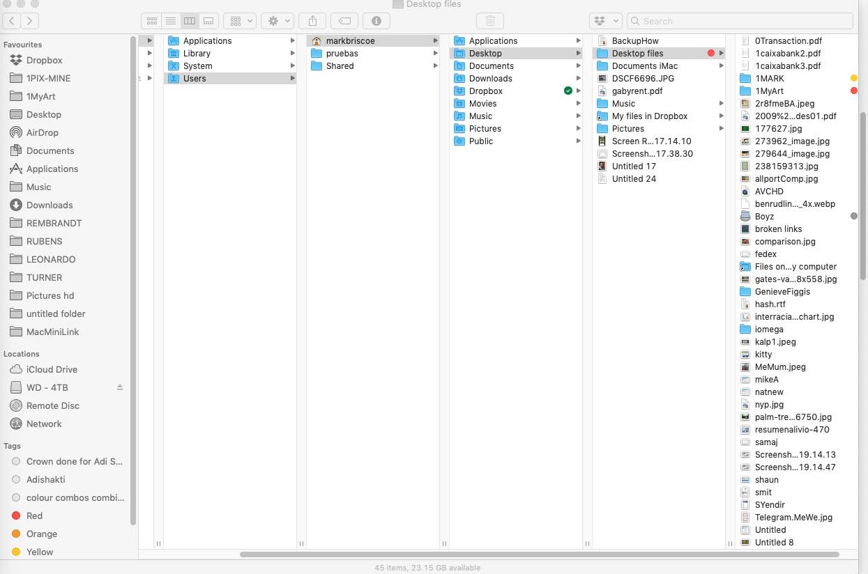

I am not very well organised generally and my Mac is no exception and has not escaped this flaw either... I am thinking that I could alternatively transfer and delete (as described above) large folders WITHIN the Desktop folder (see screenshot) the 3 main culprits are 'Desktop files' 'Music' and 'Pictures' transfer and delete those 3 and then create new alias links for them in the grey column on the left side of the finder window. Is that a possibility? And if things run horribly slowly (as Fishrrman said they might) I guess I could just drag them back again to their original spots on the internal disk and go back to the drawing board
You can drag up to ALL of what you have on your current Desktop to the external and alias any of it and put the alias in the left sidebar or on the now cleared desktop.
If you want quick & easy, create a folder on external called "OldDesktop" (or whatever you want to call it), drag it all there and then alias the "OldDesktop" folder. Put alias to OldDesktop on new blank desktop and/or in the left sidebar. That would make it all 2 clicks away instead of a single click.
If the external is fast, you probably won't notice any difference in access speed (other than 2 clicks vs. 1). If external is SSD, it should be fast. If not, fairly good sized SSDs are cheap. I just saw 2TB m.2 sticks on Amazon this morning for well below $100. Fast enclosures are under $40.
