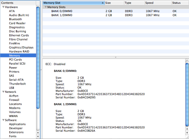

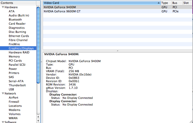

Hey, guys. I've been poking around online, but haven't found a straight answer. Because I'm not very computer-smart when it comes to questions like this, I took some screencaps of what System Profiler tells me about my computer.
So assuming I'm running a 64-bit version of Windows 7, how would you guys expect the game to run?
