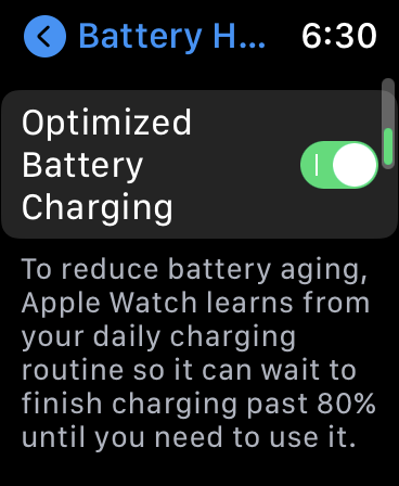

Probably not since the small pouches are already stressed near their limits. Seeing how many problems Apple has had with swollen batteries it may even be slightly slower. Also Apple has added an option to slow down charging and reduce high charge state time to increase battery life.

no its faster....significantly faster. optimized charging does not slow down charging. it changes how it charges.
I think this setting will only have an impact if someone charges overnight, or otherwise has a habit of leaving their watch on the charger for a long period in a fairly predictable way. I have the setting set to 'on' and did for the duration of the public beta. I tended to charge my S4 briefly in the evening and then again in the morning until I get the fully charged notification, with the S6 the evening charge isn't necessary, and I don't think this setting will have any bearing on people with a similar behaviour to me.
