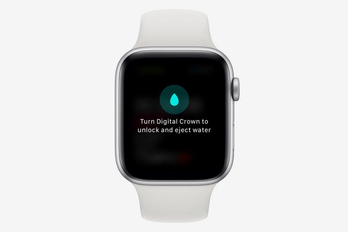

During my workout routine (outdoor walk) this morning, my S6 starting going Berzerk. Between the 3rd and 4th kilometers, my S6 started an audible string of “segment 1 mark, segment 2 mark, … segment 17 mark” over the span of a few mintes even though I had not touched my S6 since starting my workout. A few minutes later when I looked at my watch, it was in the middle of an ApplePay transaction, which I cancelled. A few minutes later when I looked at my watch again, it had somehow gotten into bluetooth settings, which I cancelled. Then at the 5.8K mark, my S6 ended my workout. A new workout was started for the final 0.26K of my 6K walk.
Has anyone else experienced anything like this? My S6 is up to date software wise @v8.1.
Are you wearing long sleeves? I found some of my long sleeve shirts activate the touch screen, leading to unpredictable behavior. I now turn on water lock when I wear my watch with long sleeves.

Sweat/dampness and long sleeves made my watch do the same. Now I activate water lock when running with long sleeves

Yes I was wearing long sleeves, plus the air was quite humid having just rained. That may have contributed also. Thanks for the tips.

It just seems odd that there is a start workout shortcut but no end workout shortcut. As I said, I made a shortcut to start a workout and turn on water lock, which I can now do with one tap. Then, when I want to end my workout, I have to dig my watch out from under my sleeves -- now that it's cold enough to wear layers, that can take a while. Then I have to roll the crown to turn off water lock, and finally swipe sideways to get to the end workout button. All this could theoretically be reduced to a single tap if only there was an end workout function in shortcut!
If you use the Apple Workout app, just say, Hey Siri, end workout. That will work.
