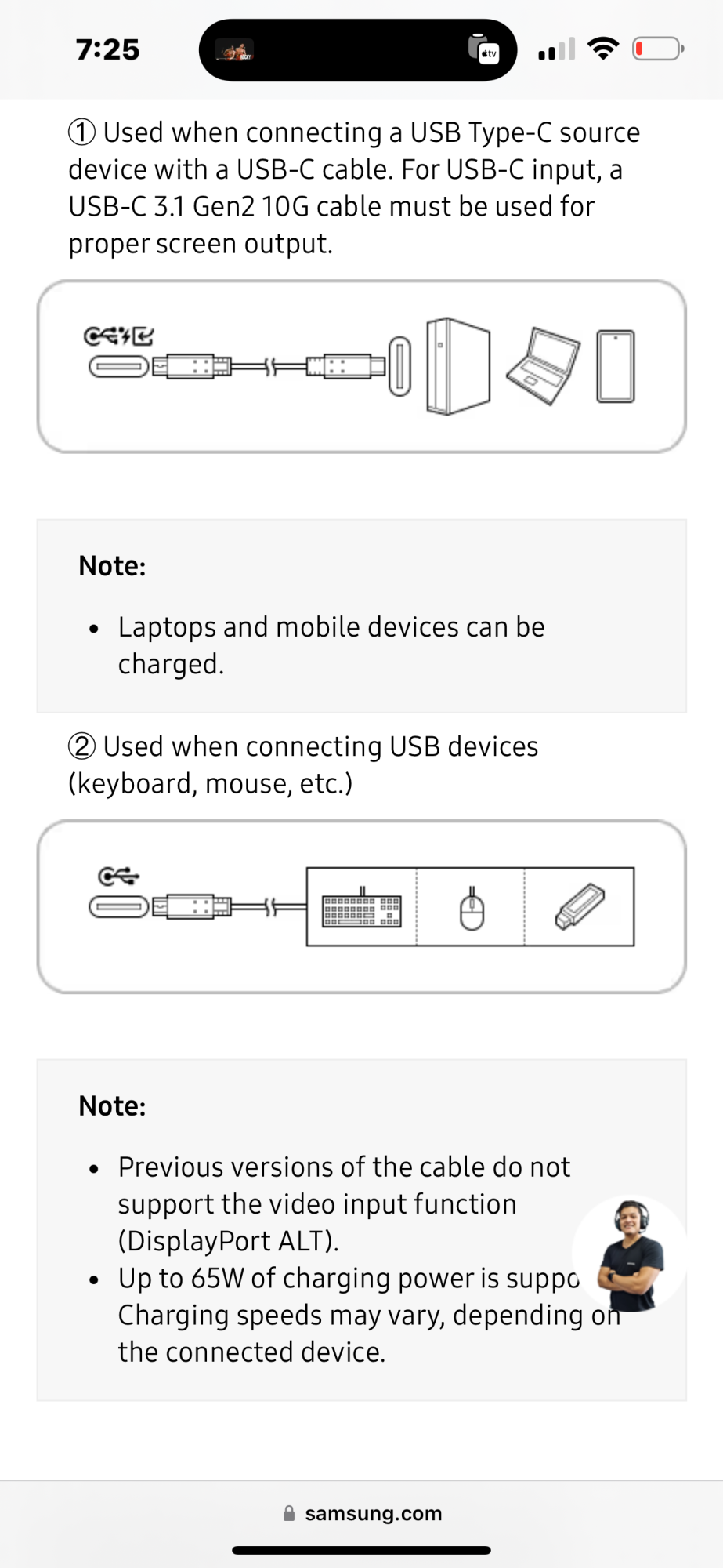

Samsung states on there website the USBC it comes with no longer works and must use a thunderbolt cable.
