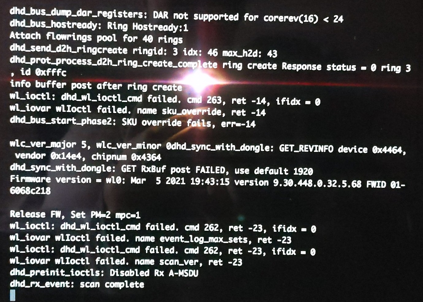

I tried running the firmware update off the USB stick in macOS, and I saw it at boot and selected it, but as soon as it changed to start to boot it wouldn't go any further. Doing the same process via Parallels Desktop Windows, it booted exactly like the video shows, except it didn't see any drives, which I'm guessing is because of Parallels somewhere. So I know the USB stick works, but apparently not for a Mac boot.
