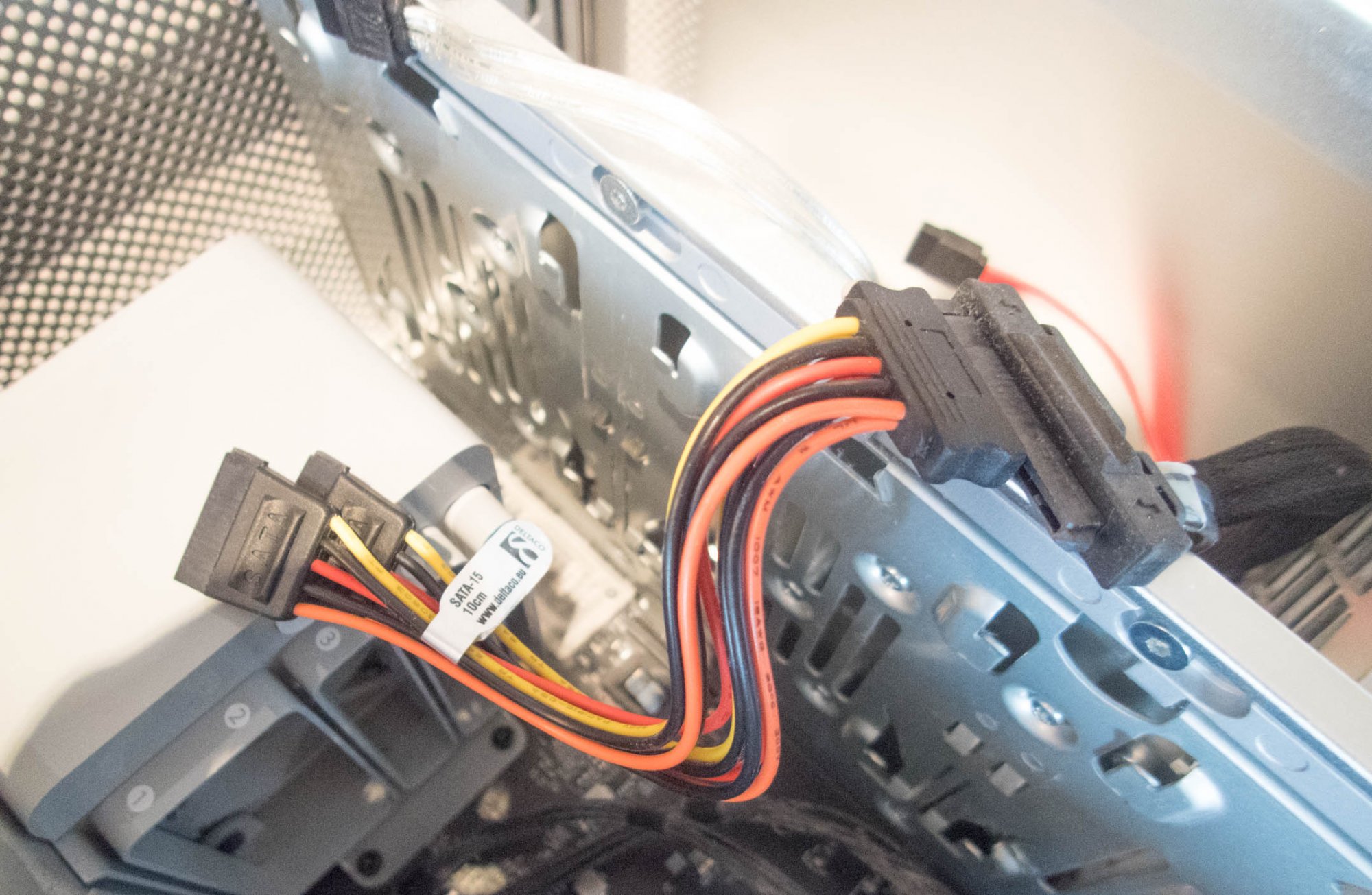

How do you wire things up if you want to put in multiple (2 or 3) SATA devices in the lower optical bay of a cMP 5,1?
I've solved this by using a SATA power-splitter cable plugged into the lower optical SATA connector (to give power to two drives), but this also means I need to run a new 7-pin SATA data cable from the backplane board's "lower" connector up to the optical bay (instead of using the existing connector).
For the other drive(s) I obviously need additional 7-pin SATA data cables, so I've run two 1m length cables from the optical bay area to the PCIe area (for attaching to a SATA-2 card I have installed).
My question: regarding the drive attached to the "lower" SATA connector, is there some sort of SATA cable/adapter which plugs into the drive as usual, but also allows for multiple power connectors for other drives?
Except for the above I'm quite happy with my setup, especially since I replaced my 5.25" to 2.5" adapter with a more versatile adapter (Sharkoon 5.25 BayExtension) allowing for a combination of multiple 3.5" and 2.5" devices. This is great if you've used up all 4 normal cMP drive bays, have a SATA PCIe card and/or use the lower optical connector (and upper as well in case you've removed the optical drive).

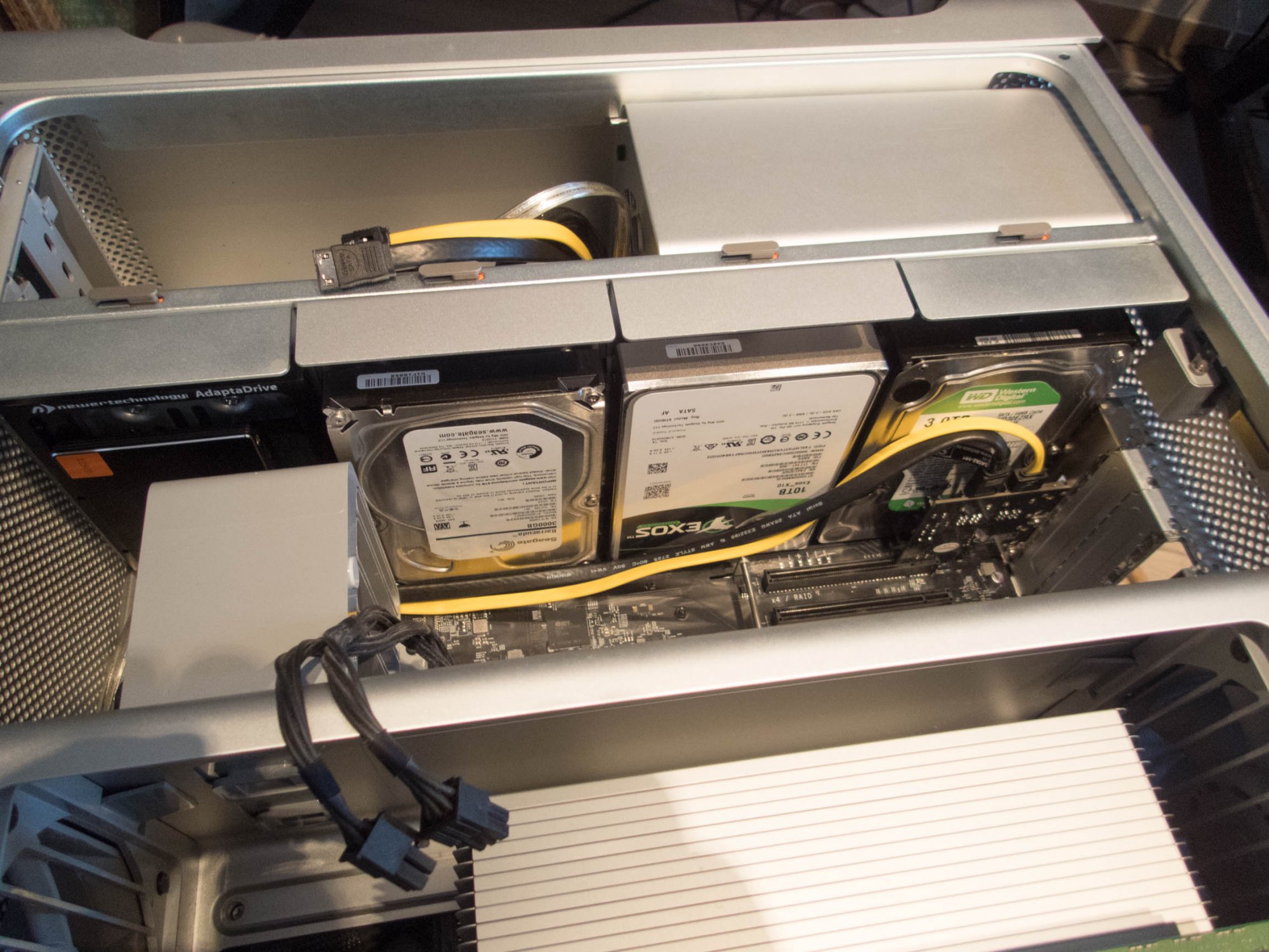

I've housed four SATA SSDs in my 5,1's optical bay for several years now... I use an external firewire-connected Optical Drive (or should I say "barely use"?) for the occasional CD/DVD burn and am thus able to use both native SATA ports for SSDs, splitting power from one of the optical bay combo cables and running the SATA signal cable as described by macstatic.
I figured out awhile ago that the best way to do this is to simply remove the optical bay drive cage... lots more room for everything, and no need to attach the SSDs to anything. I guess if you move your Mac Pro around a lot, that could be an issue, but otherwise, what's the worry? Nice airflow, and the feather-light SSDs sit happily where their attached cables direct them.
Similarly, why worry about the SATA cable running from the backplane? Close the Mac Pro case door. The machine works as intended.

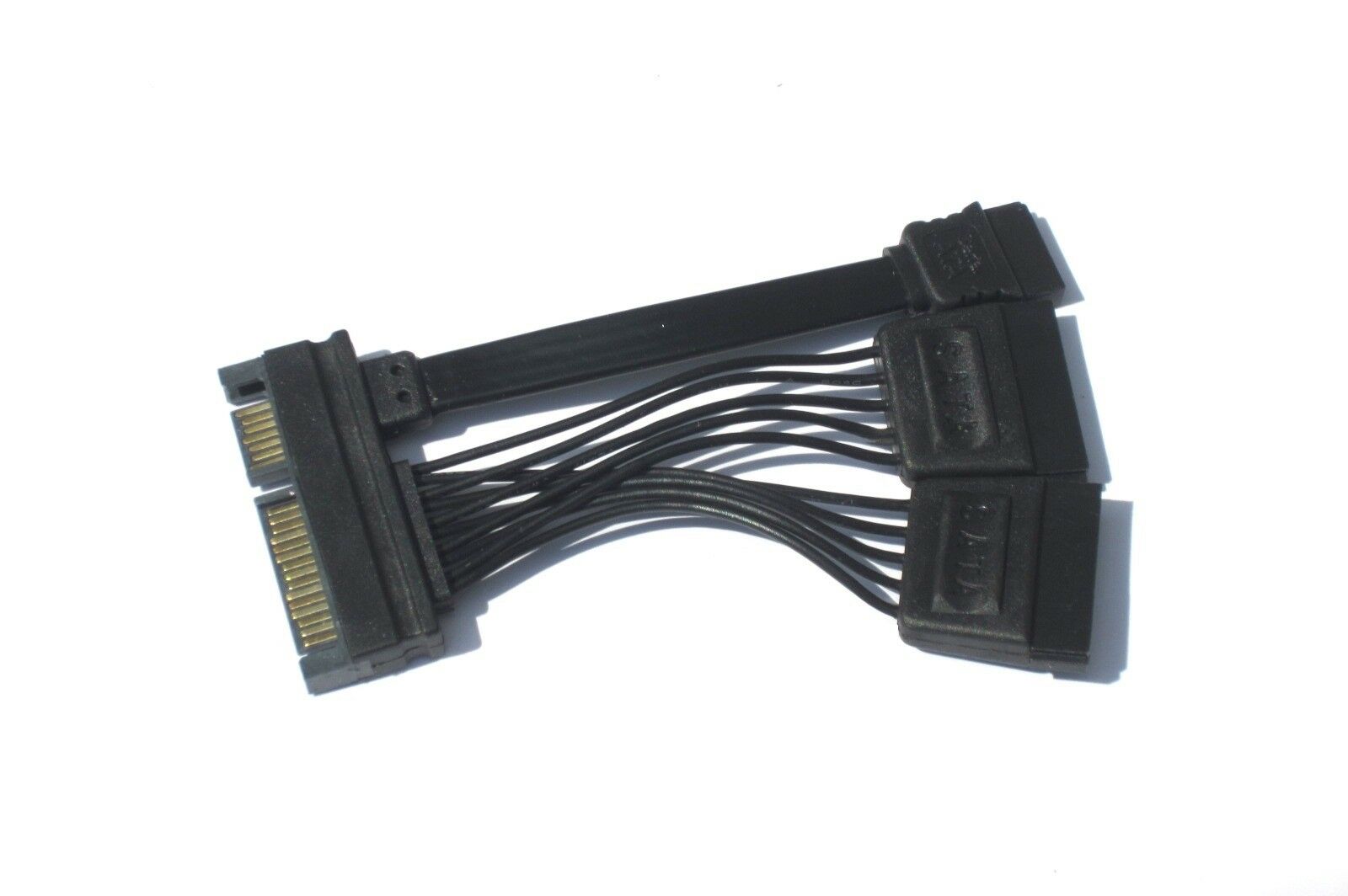

This is what I have used to add some hard drives in the optical bay, using a 5.25 to 3.5/2.5 combo mount.
This let me keep the DVD and main drive connected inline and then run additional SATA power splitters as needed.
SATA-22-Pin-Male-to-SATA-7-Pin-and-2-X-15-Pin-SATA-Female-Connectors-2
Thanks for sharing that. I'd tried a Delock extensions cable along with a power splitter, but even with all the ends sawed off they wouldn't fit in together. That will make 4 SSD in the optical bay, with two of them at 500 MB/sec (Caldigit Fast USB-SATA adapter) under Mojave. That's a total of eight drive bays in the old 5,1 tower. Not bad.
Right now I have three SSD in there.
For those worrying about power, the optical bay power connectors could handle four spinning drives easily, let alone 4 SDD.

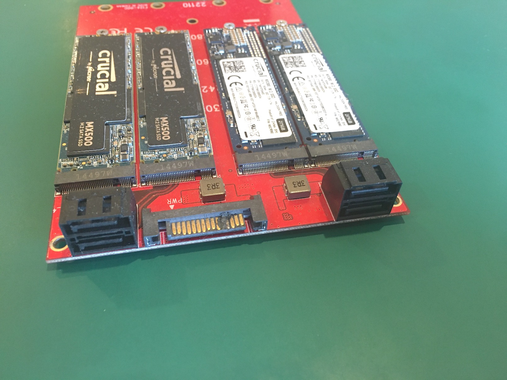

For a while now, I have been trying to build the world's most powerful* Mac Pro (cMP5,1) and it is becoming SUPER difficult because - for example - you can fit 40 SSDs (properly ventilated) in the optical bay if you drill deep enough in search of "possible solutions".
See the pictures below and really use your imagination..
(1) BUY THIS..
(2) Rip it out of the completely redundant 3.5in bracket
POWER (x10) and CONNECT (x40)
If you don't care about ventilation you could put 80 SSDs in that space after removing the drive cage. As @DPUser mentioned in an earlier post - SSDs are light as a feather. Brackets are no longer necessary.
*with no regard for any component that has long ago reached it's ceiling (i.e. CPU, GPU or RAM)
