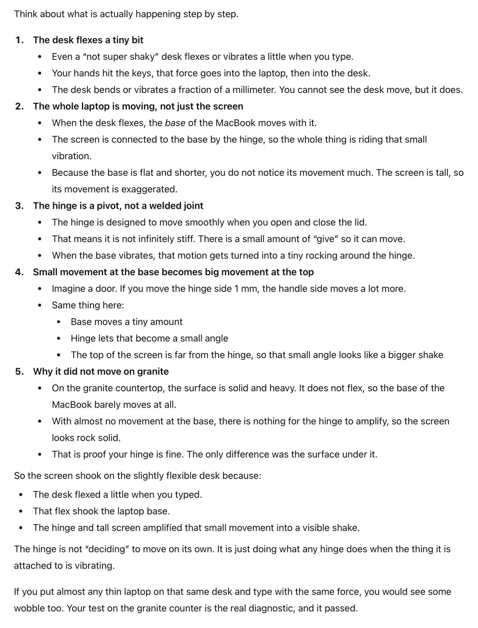

Thanks everyone for your comments and for trying it on your own Mac 🙂
What I did recently to test this was put my MacBook on a kitchen granite countertop and I typed like I usually do. The screen didn't wiggle. So I guess this is a non-issue. The screen only wiggle on desks that are not as sturdy as a granite countertop. Any time I move the device on any table top the screen wiggles a bit. I'm assuming this is because of physics and how thin the screen and base are of this device. I don't think I will bother bringing it into the Apple Store, the employees might look at me like I'm crazy lol.

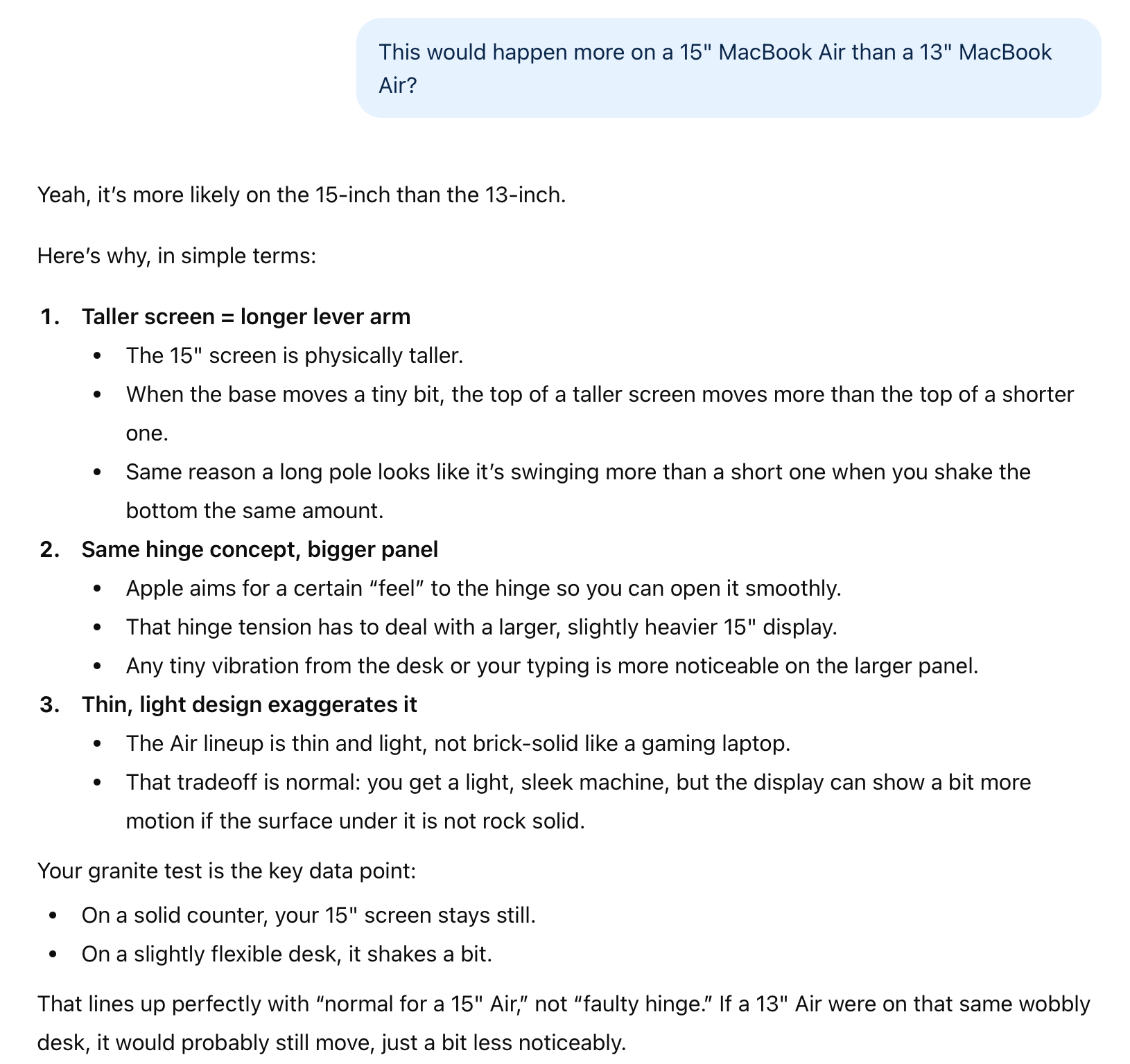

I'm also guessing that the 15" is more noticeable with the screen wobbling than a 13" version because of physics.
These are reassuring from ChatGPT:
