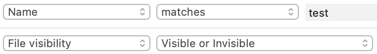

But there is no way — at least, I didn't figured it out myself yet — to show `.test2.txt`, `.test3` and `test4.txt`. At first glance, the solution is easy: click a search criteria, select "Other", there enable the "File invisible" check box, then add it as a new criteria (fig. 2).
But this doesn't help. And even worse, even `test1.txt` is not found then. In fact, this option seems to broke any search — no matter which files you tried to search, the search won't find anything.

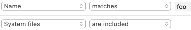

I have a test file called `foo` in my `/usr/local/bin`. Finder cannot find it, even if (the same as the second step in Test 1) I will add "System files" criteria (fig. 3).

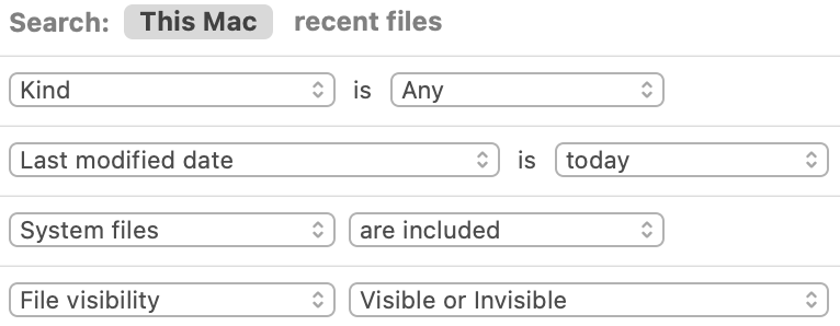

I have created the following saved search and for some reason the "File visibility" line makes the search show "nothing". In other words, if I remove the "File visibility" line, the search works correctly: it shows me the files that are modified today. But with the "File visibility" line, there are zero files.
What is wrong here? How can I fix it?
